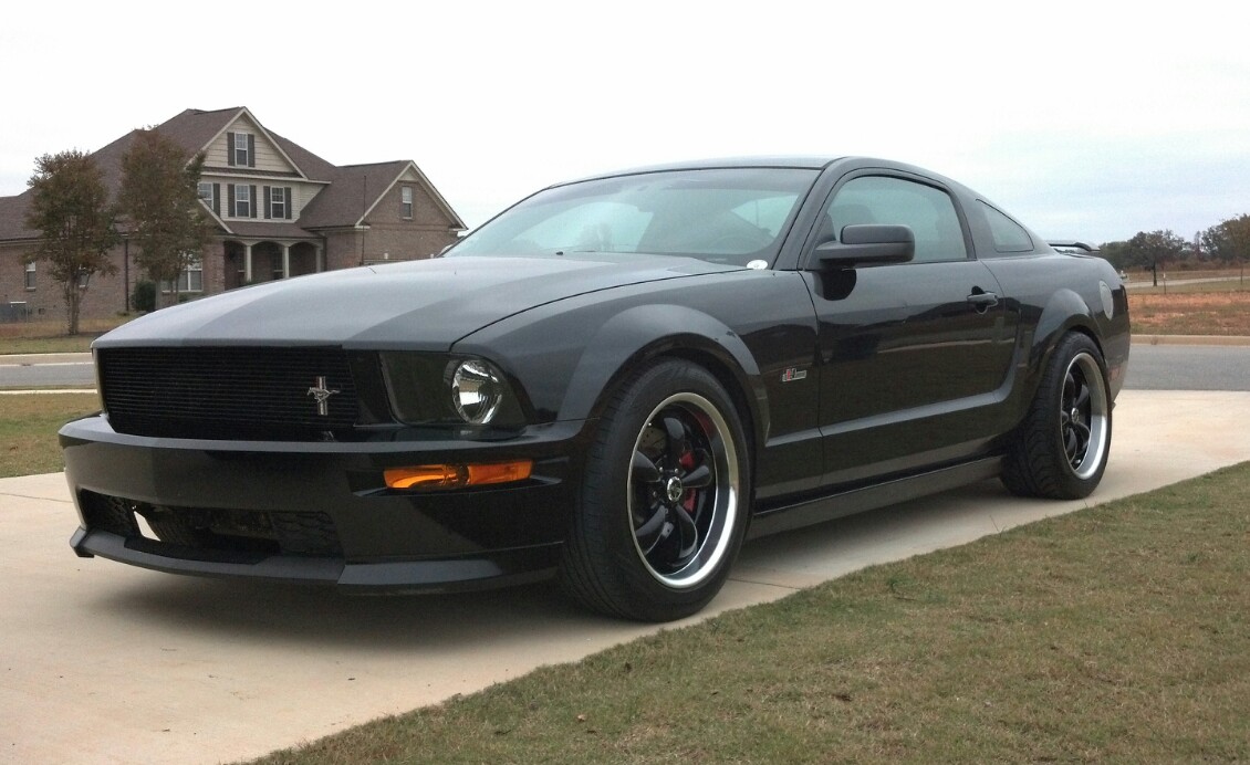

They fit and they look great to me.........thanks for the excellant help!!

No rubs so far: 235/50/18 on 18x9's in front and 275/40/18 on 18x10's in rear!

Wow. That's a great looking clean front end! Nice car

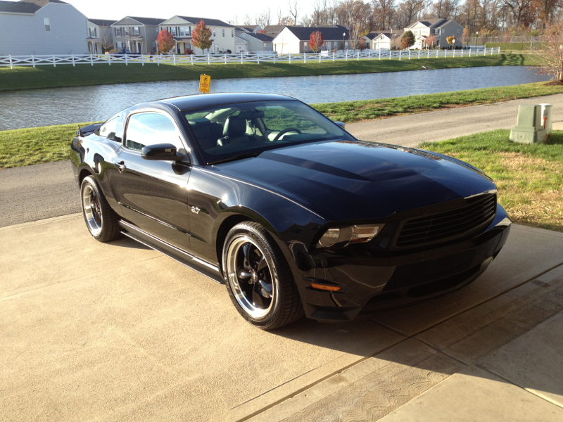

My kinda car. We may be related.

Nice! Looks like your going to need a adjustable panhard bar.

Please enlighten me........I don't know about the benifits of this???

From the pictures it looks like your driver side sticks out more than your passenger. The adjustable PHB will straiten you rear end so both sides are even.
