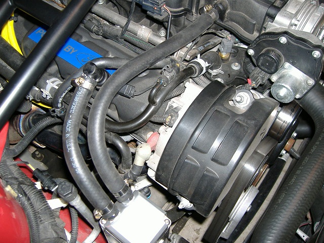

on the 05 something else you should do is a bi-pass to the coolant hoses going to the throttle body. they omitted them after 05. they are not needed and it makes removing the tb real easy (4 bolts-2 connectors) which at the same time you should remove and clean. get a can of tb cleaner at the auto parts. the inside should look like clean alum with no black. thats gonna help all around performance. heres a post i did on another forum back on 08. it shows a pic of where the hoses are. i just used the longer hose and made a loop, but you could just block it off any way you want.

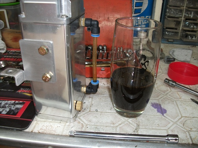

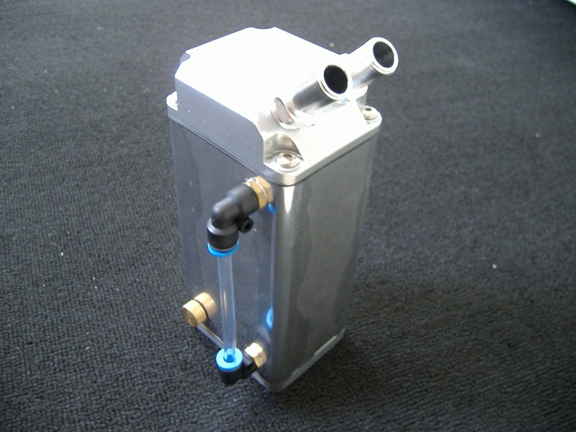

another thing sorta cheap that i wish i would have done alot sooner is install a oil catch can between the PCV valve and the plenum. it keeps alot of oil from going into the intake, which coats everything. i got one off ebay for $30. ive got some install posts on this if you ever need it
