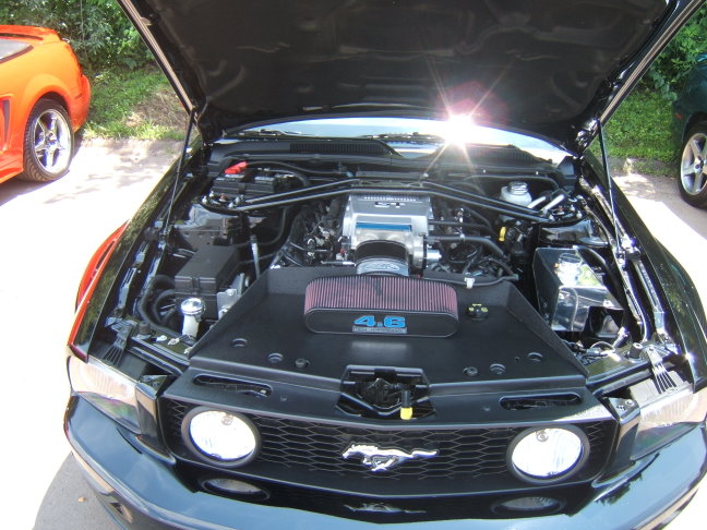

I agree with the lyin'king.No Big deal to cut and splice the the six wires.I did mine last September and and had none, zero problems with the wiring or the CAI In fact I ran a stock tune until about a month ago I finally bought a SCT-2 from Brenspeed and put the 93 tune on.What a difference more low end torque pulls much stronger and NO 2000 RPM lag when stepping on the peddle and actually getting around 2 mpg better fuel economy.Here is the finished product.
