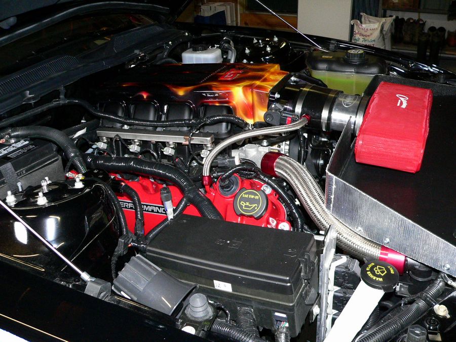

I've had mine since October. Works great.
Don't forget the Prefilter from Outerwears. It keeps the bugs and stuff off the filter. Much easier to clean.
I also have the 95mm MAF meter. It's overkill and not much difference then the gains using the 80mm meter. I had my tunes done by Brent at Brenspeed.com. He has this setup and has done some testing with both the 80mm and 95mm meters.
I added the heat shield tape and sheeting to the underside of the tray. The tray is only warm to the touch when you open the hood after driving for awhile. I'd bet with the Cal Dream Ram hood or the Fang Performance Mystery 8 hood you could dump the air right into the tray. I'm patiently waiting for the Mystery 8 hood to try with the WMS tray.
Cutting and spicing the MAF wiring is the only real down fall of this CAI. Get a MAF extension so you only have to do 6 splices instead of 12.
