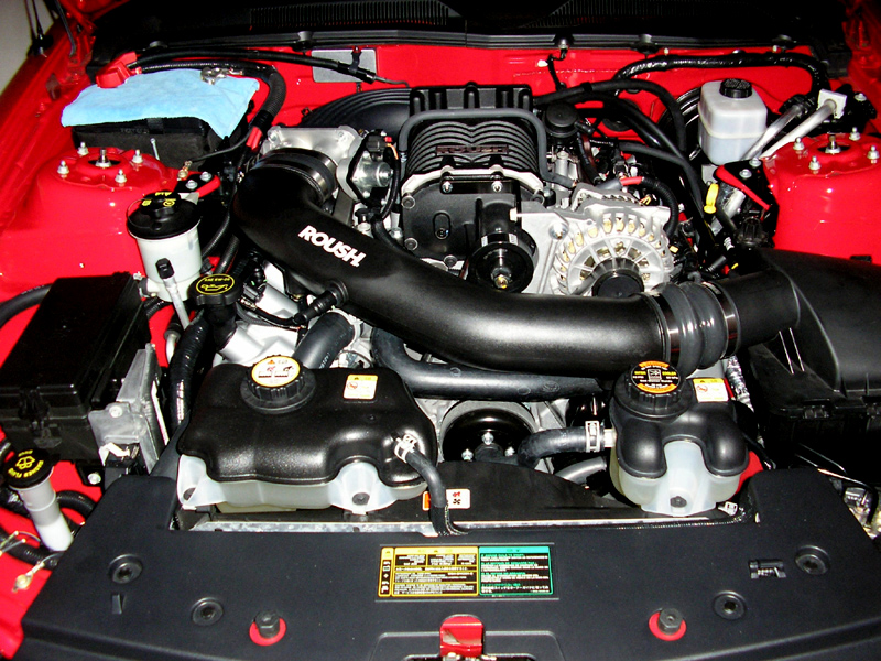

For a no-hassle, put-it-on and forget about it supercharger kit, you can't do any better than the Roush system (5 psi). It simply doesn't have the lungs to compete with the rest of the more racey superchargers, but wasn't designed to. It seems like the perfect choice for what you want to do, and it was the perfect choice for me. The engineering has already been done, just bolt it on and enjoy. There will be power upgrades available from Roush and others later should the need arise, but nothing like what is available for the larger superchargers. The power range seems to be between 355-370 rwhp, with a few making 380s.
That said, you can achieve low boost with any of the kits that are available.
Here's mine:
Attached Thumbnails Which supercharger offers the lowest boost?-engine_front_done.jpg
