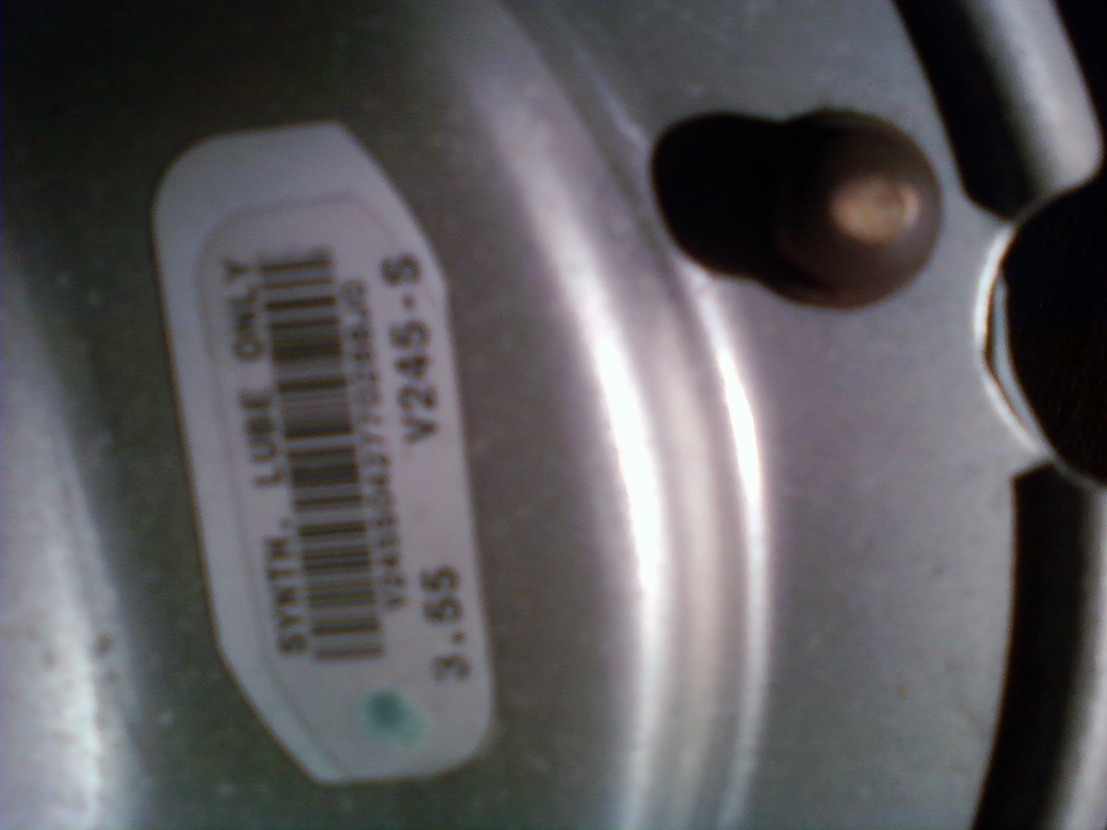

hey all I just got my mustang a few months ago. I have a question on the rear axle cover I found a sticker that has 3.55 on it what is the stock for a 2005 GT, and is the stock gear cover unpainted steel or aluminum. see I bought my car with 51,000 miles on it and the dealer made no mention of any improvements. any help would be greatly appreciated.

yes stock the 2005 gt has 3:55 gears, but that dont mean anything if they did a gear swap and put the cover back on with out ripping the sticker off. gear swaps for this car is a hot item, so make sure it is actually a 3:55 ratio. As for color i believe it is unpainted aluminum but dont quote me on that. when you change your gear oil make sure you go to ford and get a little bottle of limited slip additive(motorcraft brand ofcourse) because its to make sure that your rearend dont lock up. this you have to perform every time you change your gear fluid, its very important. Make sure you add the additive first then the gear oil of your choice and stay synthetic with the gear oil. anymore question please ask away i have a 2005 gt as well that i have had since febuary of 2005 and i know this car pretty good top to bottom.

Yup, 3.55 L/S is stock for 2005-2006 GT 5M models. It became an option for the GT 5M cars sometime in 2007.
