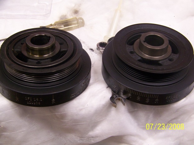

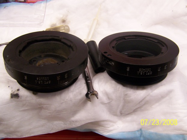

I don't want to be an alarmist but there were a very limited number (3 or 4 in over 1000 units sold by my supplier) of Steeda UPD crank pulley problems but the noise would come from the crank pulley as it begins to separate and causes the belt to wobble.
See pictures below...old pulley on the left, new pulley on the right in both pictures. But this would not be something you would notice immediately after install. This was after about 12,000 miles and a little over a year. My supplier replaced the pulley (I did labor) under warantee.
