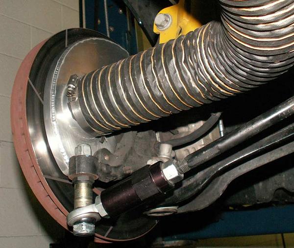

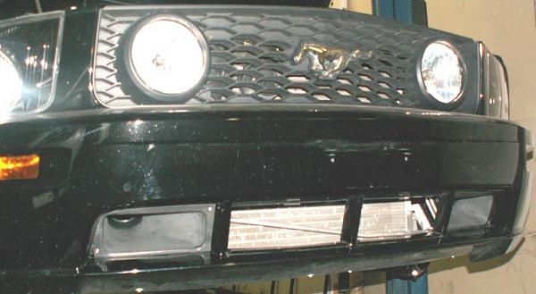

Here is what rossmustang.com has to offer but it was not yet on their website...for around $360. These are pictures supplied by rossmustang.com
Attached Thumbnails Steeda Brake duct kit-ross-mustang-brake-cool.jpg   Steeda Brake duct kit-ross-mustang-brake-scoops.jpg
Old Jun 19, 2007 | 12:08 PM
AirGoNomyk's Avatar
Joined: November 1, 2006
Posts: 190
That sure looks like the Agent 47 I have on my car...

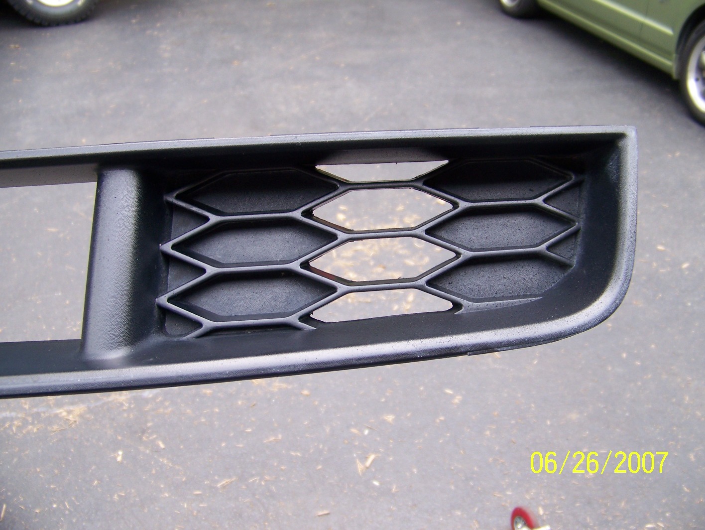

Anyway, my whole intent is to gain a little more life from the stock rotors on the track, specifically Mid America Motorplex in Iowa. I overheated them (they are now blue) last year using Hawk Plus front pads and stock rotors but I did not experience any fade. Sure, I could go to better rotors, slotted possibly, for around $500 or more for all four corners but I only need them for the track and I spend more time on the roads than the track. In my book, around $100 for a brake cooling set-up is more cost effective. I am trying to make my own. If it doesn't work out, I'll let you all know.
Here is how I modified my stock lower grill which I will use for the track only. I'll reinstall a stock grill without holes for normal street driving. I still need to somehow mount the ductwork to the back of the bumper cover.
