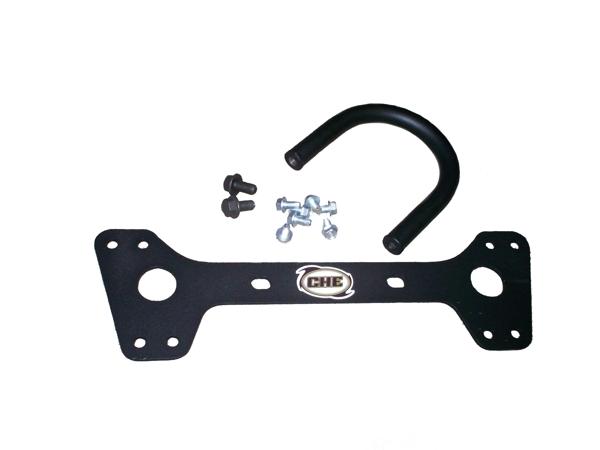

You should look into the CHE Driveshaft Loop

BMR vs CHE front loop. We need a group buy!

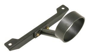

I'm running the Spyder shaft along with the BMR loop with great success. Maybe it's just me but I don't see any comparison between the CHE & BMR piece, maybe that's why I went the BMR route

Your right IMO ! The BMR loop looks to be a superior piece.

the CHE one looks like a "U" bolt attached to a frame
