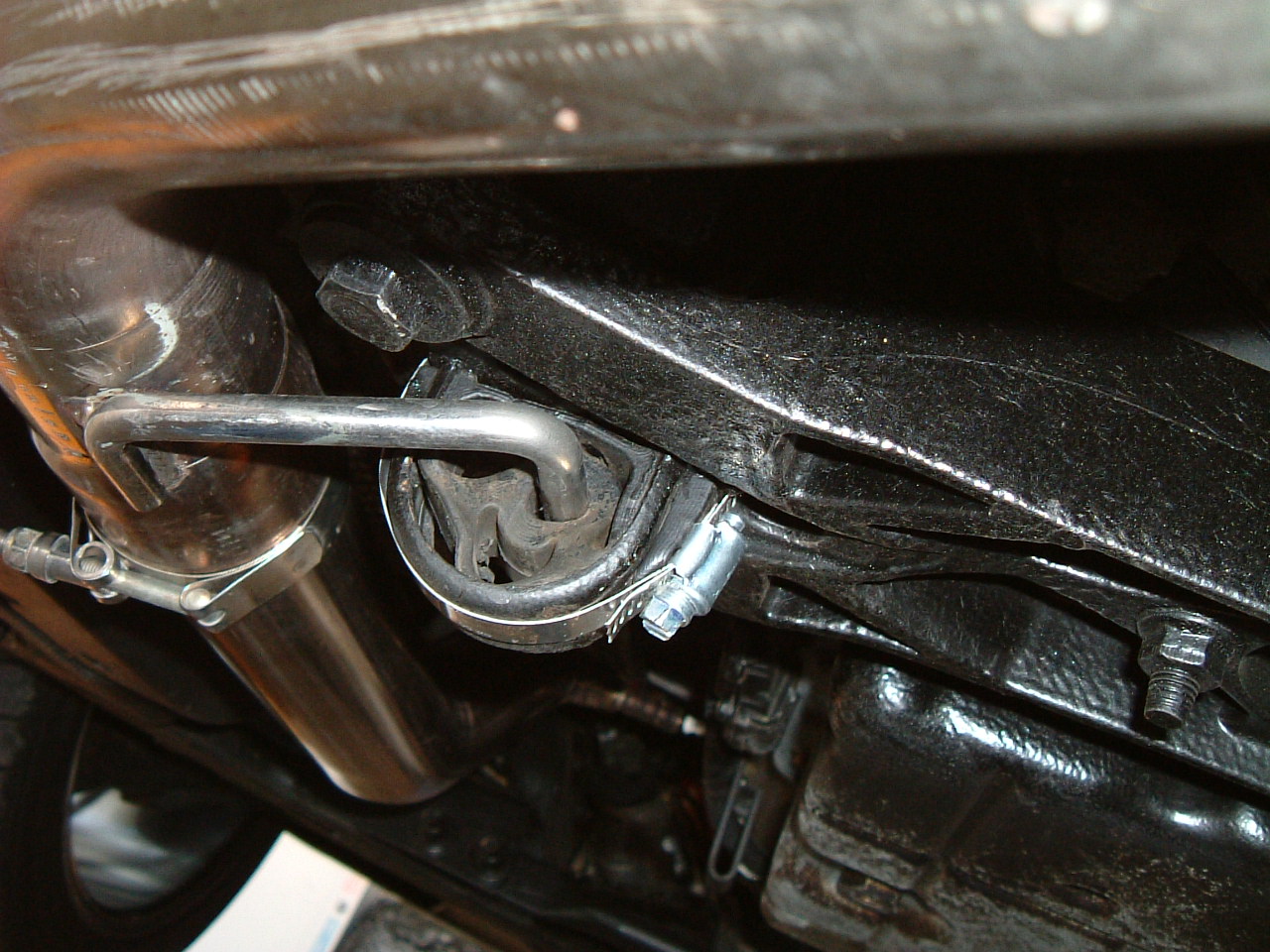

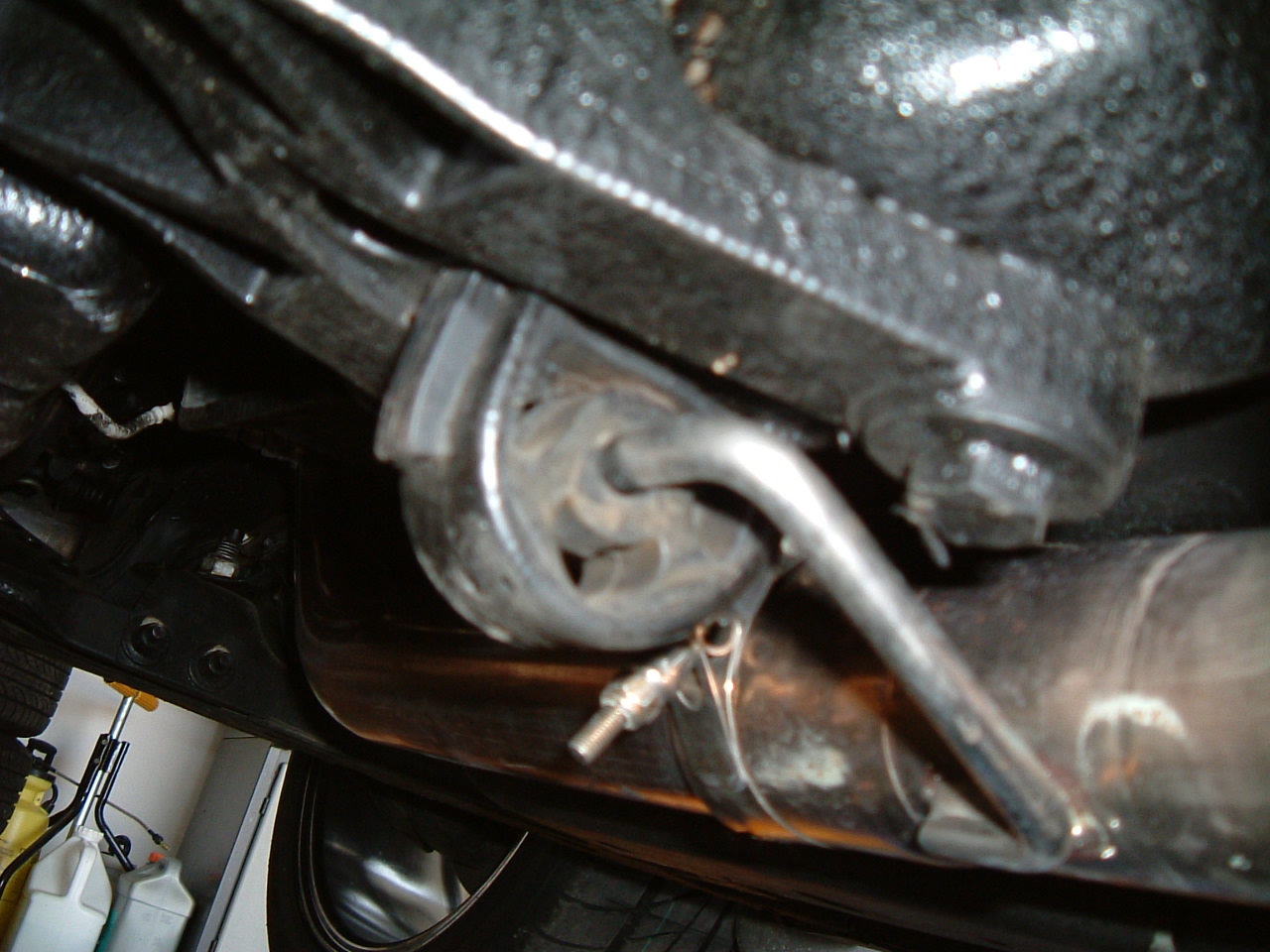

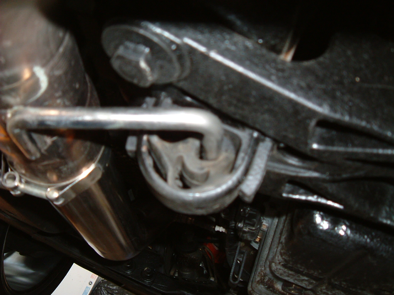

As I was just about to tear the dash out of my car today you made your post about the TSB's and I started looking under the car again. I have always said that this buzz started the day I had the Prochamber installed. Well I was correct. Thanks to you Steve I did a search and found this http://bradbarnett.net/mustangs/gala...er_console.pdf
So I raised the car back up this afternoon and found that the exhaust hanger on the drivers side of the transmission mount was loose just like the TSB says. Here is why it is loose...take a look at the pictures and you can see that the hanger on the Prochamber is welded out of position and forcing the rubber bushing all to one side. I now believe this forced the hanger to loosen itself as I drove with the stock H pipe for 1 1/2 yrs. with no issues. Now for the fix. Per the TSB a $1.25 SS band clamp fixed the issue. While I am not thrilled about such a chicken chit kind of fix... it works.
Buzzing is Gone!!
Thanks again Steve for making me take another look.
