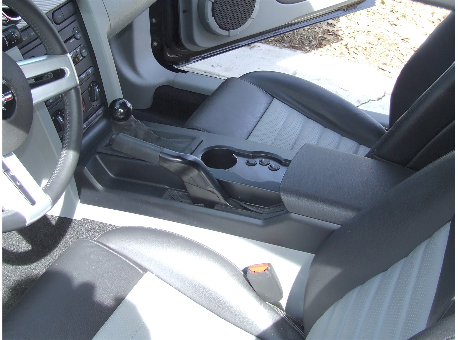

Hey Brad, don't you think this Pro 5.0 looks pretty good!
Attached Thumbnails Pro 5.0 vs. MGW, for those who have used both, whats the verdict?-324.jpg
Yep, looks good with the Hurst goodies!

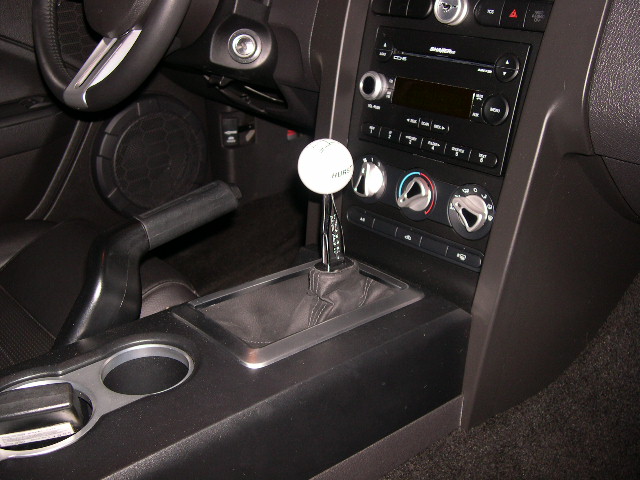

The MGW looks good with Hurst goodies too!
LOL ignore the hair ties. Those are my knocks in the wood...
