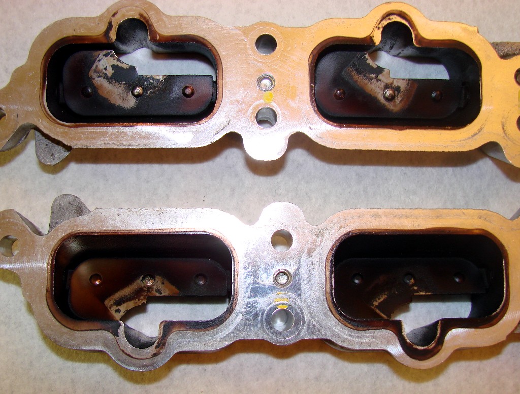

Here's a good reason why you should put an oil seperator on your car!
Well said!
