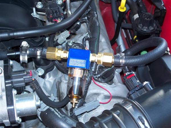

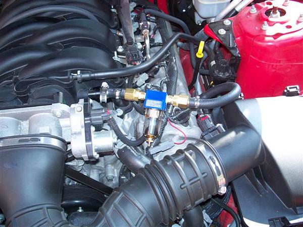

A question?? Just messing around I installed a Kobalt (Lowe's) air/water/oil separator. The bottom of the separator is drawing a vaccum. The little **** on the bottom just opens and closes the drain. Is this right??? I can put my finger on the bottom and feel it. My boost gauge looks OK and my Oil pressure gauge reads fine. Is this normal??
Thats the same one I used. I used JB Weld on the valve part in the bottom of the separator to seal the vaccum off. It probably isnt hurting anything but that little bit of vaccum is unmetered air going into the engine, thats why I sealed mine off. The temps should be fine the container itself is rated up to 200 deg and 150psi. I have had mine on for 2 weeks with 0 problems and I havent had to drain it yet. I have collected about 1/4 of the container in oil. For me this is a good thing because any oil that gets burned in the combustion chamber turns into carbon build up on the piston tops, valves and combustion chambers. This will cause pre-ignition, pinging, over a period of time which will kill our cars. They make our cars for everyday drivers that have very little mechanical knowledge. Why do you think the owners manual are written with such little detail. Its hard enough to get people to change their oil I really dont think they would remeber to empty a collection container. Besides if they would empty it dont you think alot of that oil would end up on the ground or in a drain because there is "just a little". If you look a 99% of all N/A pro cars they all have some sort of seperator. Not because of boost blow by but because of the ill effects of the carbon build up created by this burned oil.
Attached Thumbnails Oil Separator vs. (benefits?) of blow-by-100_0847-small-.jpg   Oil Separator vs. (benefits?) of blow-by-100_0848-small-.jpg

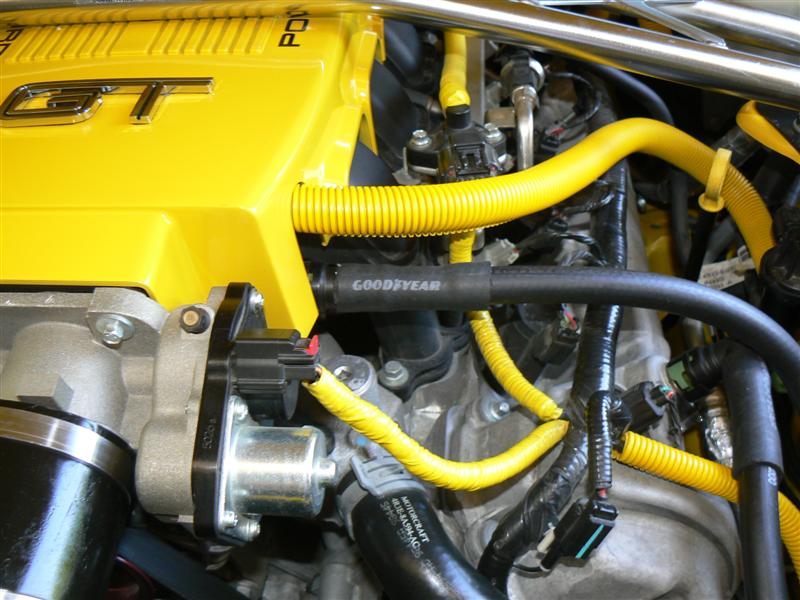

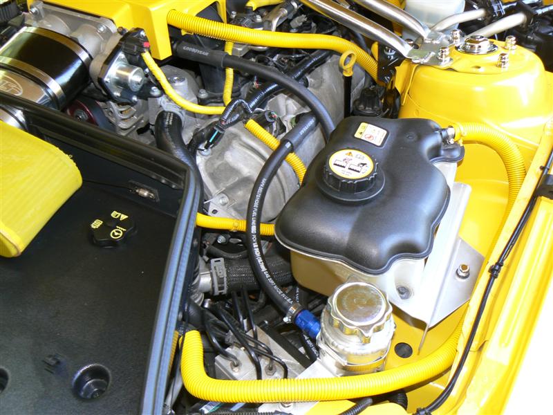

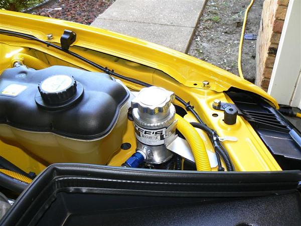

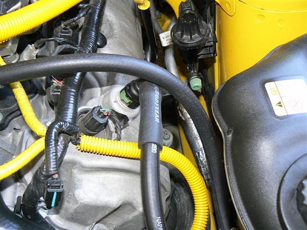

Here is my install.
See pics. the hose from the PCV goes to the side fitting, the hose from the intake goes to the bottom fitting.
Since using the Stefs for the last 3 months the inside of thottle body no longer gets loaded with that black crap. (I'm sure there is a more scientific name for that stuff)
I retained the intake and PCV quick connects for ease of service.
Attached Thumbnails Oil Separator vs. (benefits?) of blow-by-p1000307-medium-.jpg   Oil Separator vs. (benefits?) of blow-by-p1000308-medium-.jpg   Oil Separator vs. (benefits?) of blow-by-p1000309-medium-.jpg   Oil Separator vs. (benefits?) of blow-by-p1000310-medium-.jpg
