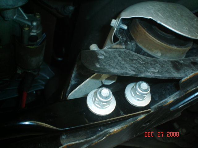

Posts: 2,298
From: Tampa FL
Thumbs down
OK resurrecting an old thread here - my wife got me one of these for Christmas and I'm not very happy at the moment. I jack up the car, get under there and there's no place to mount the brace . My car was built 12/04 so that might be the cut-off date for the flanges mentioned in a previous post in this thread. Does anyone know if FRPP will either refund my money or give me the correct parts for an early 05? Believe me, they're gonna get an email about this. Fracking bull****.
The early 05 stangs did not have the mounting holes. I belive there is a aftermarket retrofit that might be able to help you out. BTW its mentioned in the first page of the thread that the early 05's didn't even have the brackets if im not mistaken.
Old Dec 29, 2008 | 03:57 AM
  #92
MTAS's Avatar
Posts: 2,298
From: Tampa FL
Post
Correct, post #8, but at that time the cut-off date wasn't known. My luck the cut-off date was 12/15/04 when my car was built), right before the Christmas shut-down. I'd bet that the first S197 built in 2005 had the flanges

Thumbs down
I called Ford Racing and the guy who answered the tech line said I'd have to drill holes to get the thing to fit . Apparently they (Ford Racing) are well aware that the thing won't fit early S197's, but don't see the need to put a disclaimer on their site where the part is listed . So I have to go buy a $75 right-angle drill to get this part to fit? No thanks - I'll return it to Brandon Ford and go buy the BMR piece. BMR's shop is 15min from my office.

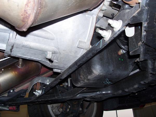

Originally Posted by metroplex
Here's a photo of the A-arm brace installed.
The FRPP unit is the same as the OEM brace, but includes the 4 nylock washers and nuts. IIRC, if you order the OEM brace using the OEM Ford part #, it will run $186 and does NOT include the nuts.
What is the car to the left of the picture? I can see a lower body stripe.

metroplex's Avatar
Joined: October 2, 2006
Posts: 4,777
From: Southeast Michigan
That's the Crown Vic. The stripe is probably some odd reflection.
