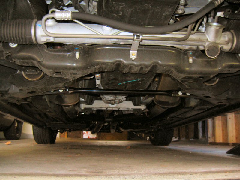

I finally got the opportunity to install the FRPP/OEM A-Arm brace. I used a 1/2" drive 15mm socket to tighten the 4 included nylock nuts. I torqued them to 46 ft-lb and it seemed like a solid fit. It took me less than an hour to drive up the Rhino Ramps and install the bar.
The part number for the bar and 4 nuts: M-5025-A

Here's a photo of the A-arm brace installed.
The FRPP unit is the same as the OEM brace, but includes the 4 nylock washers and nuts. IIRC, if you order the OEM brace using the OEM Ford part #, it will run $186 and does NOT include the nuts.
