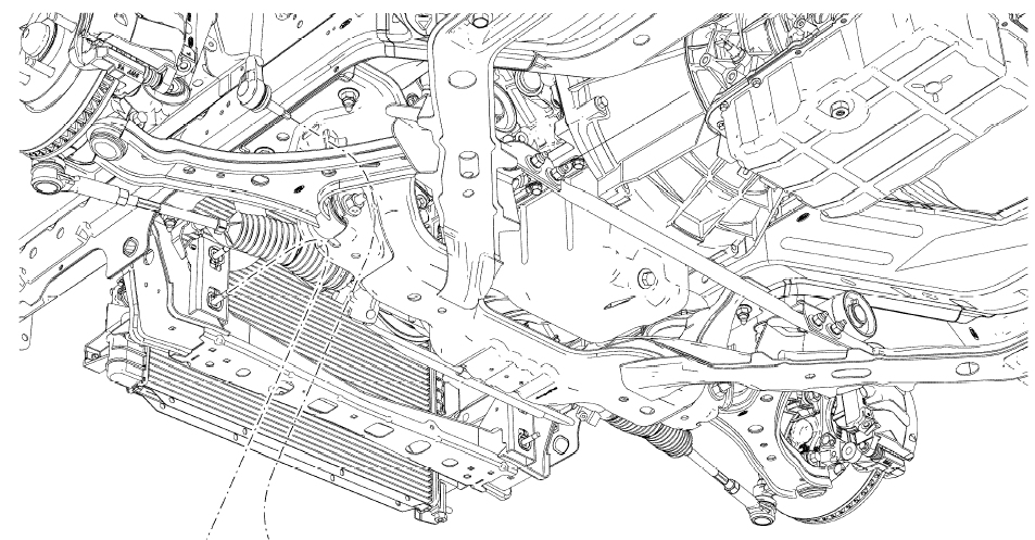

OK, so does the brace bolt to the front of the tabs (closest to engine) or to the back of the tabs (closest to the transmission)? Just curious, but does anyone have a pic of what a factory installed brace looks with regards to which side of the tabs bolt to as well as what side the nut goes on? TIA.

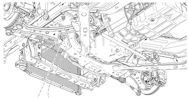

Here's the diagram from the 2007 FSM. I searched high and low, the FSM just does not acknowledge the existence of this brace. It was used on 05-up convertibles and the 07 GT500 so the brace isn't brand new for 2007. It even carried a 2004 part number!
The studs face the transmission.

Wow, thanks. That is exactly what I was looking for. Now if only the FSM had the torque specs.
