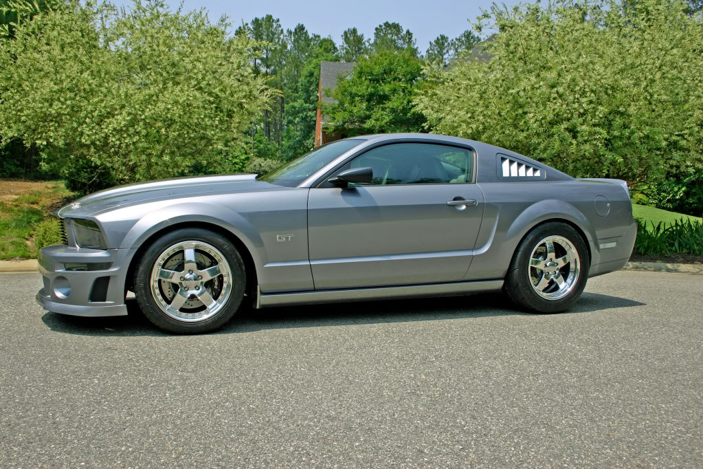

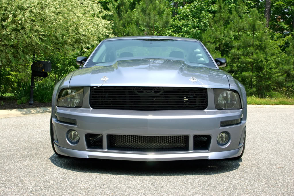

I had the Steeda Ultra-lite springs in the front of mine but when I put the TT setup on the added weight of everything made it so low I was scrapping on everything. I put the stock front springs back in and it sits just fine for me now. Is your SC a TS or centrifugal type? A TS setup should weigh about the same as my TT setup, a centrifugal will be less.

If you want lowering springs I would get something made specifically for the GT500 instead of the regular GT. I actuall like the stock fronts with the added weight. The ride quality isn't bad and the car sits about right for me. I still have the Ultra-lites in the rear.
Earl
