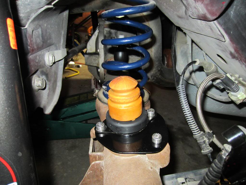

I went with the Ford Racing Jounce Bumpers, pictured here before they were trimmed a little.
