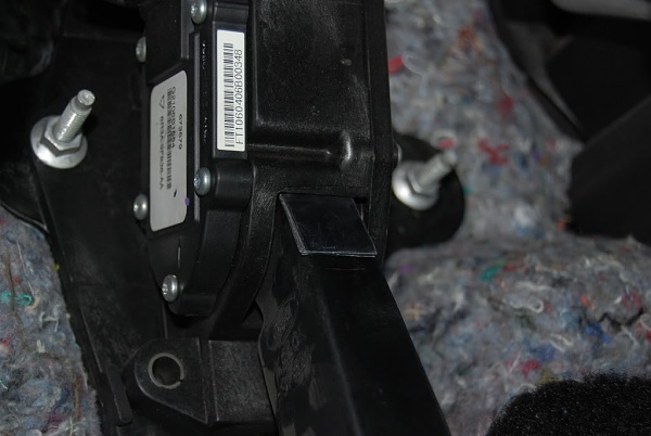

Some of the dead spot in the pedal can be mechanical also. Manufacturing tolerances are to blame for this. No tune can fix that part of it. Here is an easy fix without having to change throttle response in the tune. You can overdo it and make it too sensitive. Anyways I first used some double sided tape just to see how much pedal travel I wanted to take out at the top.

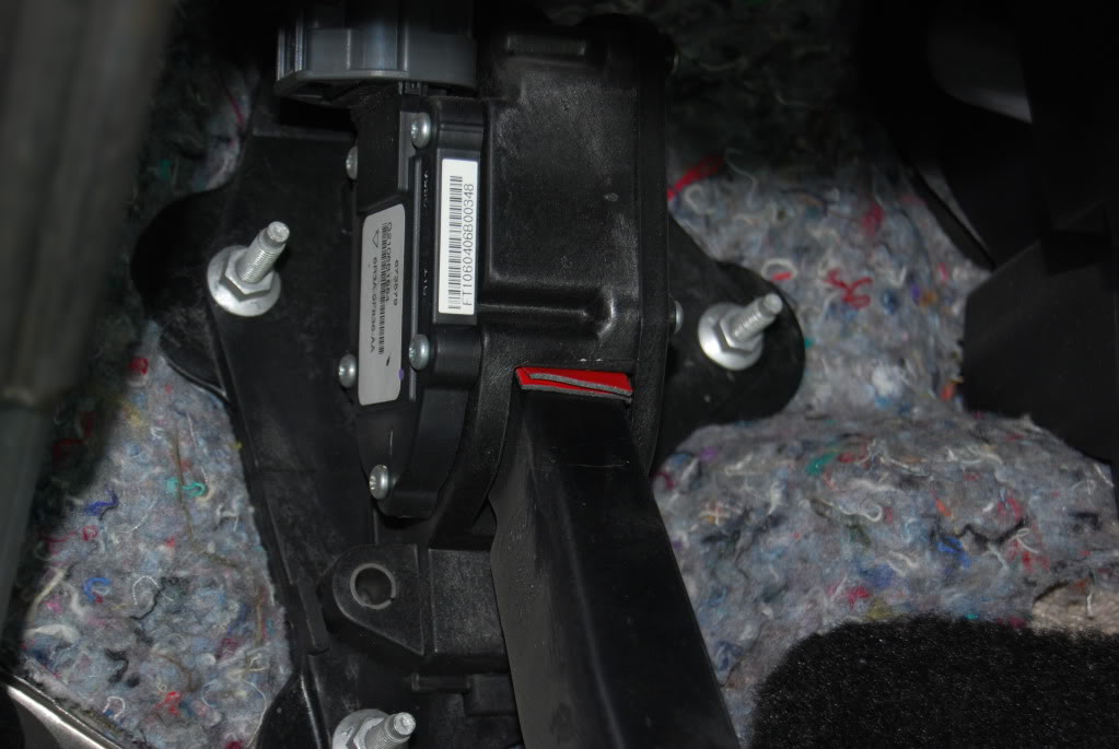

Then once I got it to about where I liked it I used lead tape and built up about 12-14 layers to get it just right.
This will eliminate any dead spot. And then go get the tune adjusted for the actual response, pedal position vs throttle blade angle.
Don't worry about making it too thick. The car re-calibrates the pedal at idle when you start it. it's not like it's going to rev out of control like a runaway diesel.
