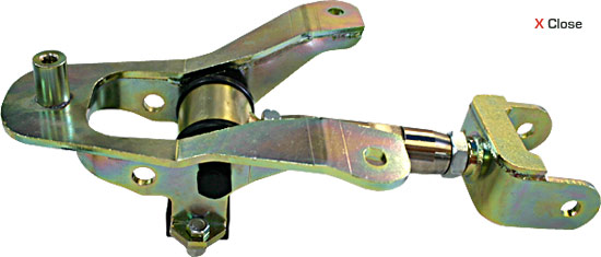

Which hole is the correct mounting hole for the upper control arm in the mount?
Is it the one pictured or the other one?
Attachment 32372

Yes, install the rearward holes as pictured. Didn't you get the instruction sheet from Steeda?

Yes I did but I cant get the pinion angle set in this hole. I'm Plus 4deg instead of -3.

The instructions say the "front" hole. To me that meant towards the front of the mount. That is where I installed mine. Made the link 10.2 inches long and the pinion angle was only off by 1 1/2 deg. A turn or two and the pinion angle was at -3deg. The instructions said that the stock link is 8.5 inches long. For that length of link the rear hole would be about right. 10.2 inches long would make the front mounting hole about right.
Maybe a call to Steeda is in order?

Yep I'm planning on calling them now. "front" hole is really subjective....if you look at their directions the picture shows it in the hole pictured above...
I know I'm going to have to pull it whole unit back out to change that, and it just ****es me off.

ok Steeda say use the hole towards the front of the car. NOT the one pictured in there instructions. So I'm off to uninstall and reinstall.
Hopefully this thread saves someone else from doing the same thing....because putting this in is a PITA.
