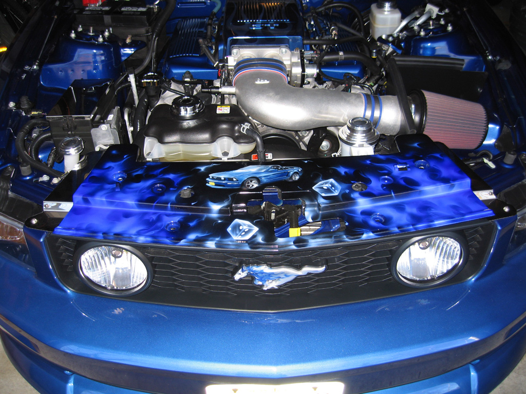

Old Jan 20, 2007 | 10:59 AM
Doug@C&L's Avatar
Joined: July 28, 2004
Posts: 848
The C&L does stick up just a bit but that is to help create a good seal between the hood and the engine bay to help prevent hot air from entering the air filter.
You may need to loose the TB hose and try and puch the MAF end of the tube down just abit but everything else looks fine. The hole for the ziptie should be right beside the ABS metal lines.
