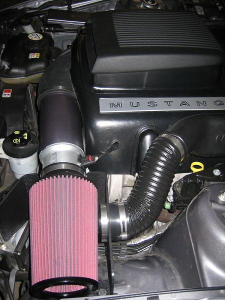

I started the work on the install (actually, the tear-down) yesterday and this is what I have so far:
Attachment 34852
So far, the front bumper cover and the headlights have been removed.
I'll do little things this week (remove windshield washer tank, drain coolant, drain oil, drain power steering fluid/remove reservoir, etc.).
By this weekend, I'll have the complete kit so I'll start on more major stuff (H-pipe has to be removed and modified, radiator as to be angled slightly at the top, etc.).
Of course, then there is all of the plumbing, the turbo mounted, the intercooler mounted, etc.
Then I have to remove the shaker, change injectors, remount the shaker...
I'll post pictures and updates here along the way!
