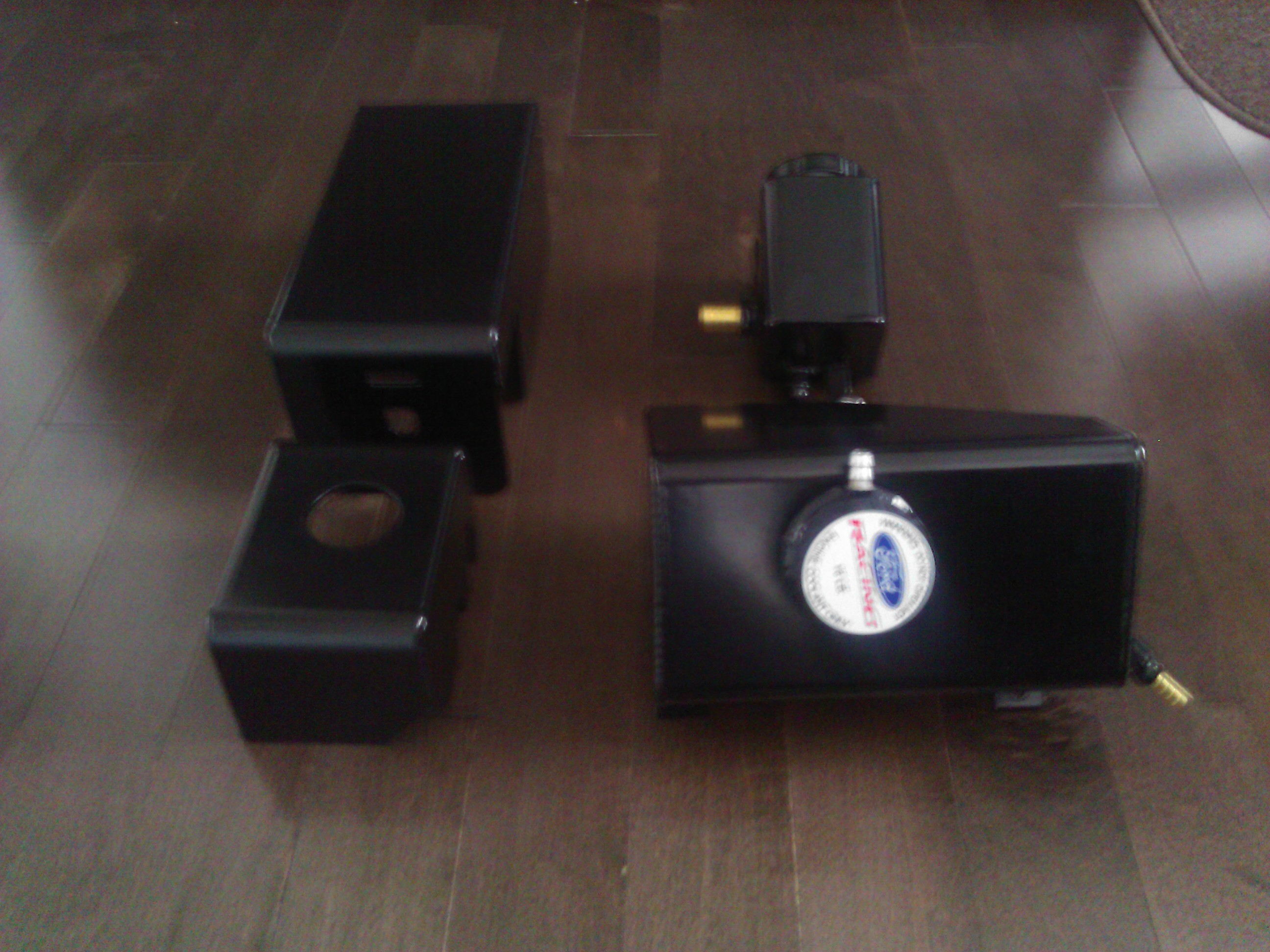

I finally got my supposedly FRPP (etched on Canton) coolant reservoir and Canton power steering fluid reservoir back from the powder coater.
I also got him to powder coat my Moroso fuse box and brake cylinder covers at the same time.
I was wondering does anyone have or know of any good DIY write ups for installing these reservoirs? I have looked on the net/forums but have found minimal information.
I was also wondering does anyone know what is the best way to remove the hoses that attach to the reservoirs? Is there a tool that is needed or do you just lift or squeeze the clamp that attaches the hose?
Here is a picture of everything after the black powder coating. I am very happy with how everything looks!
