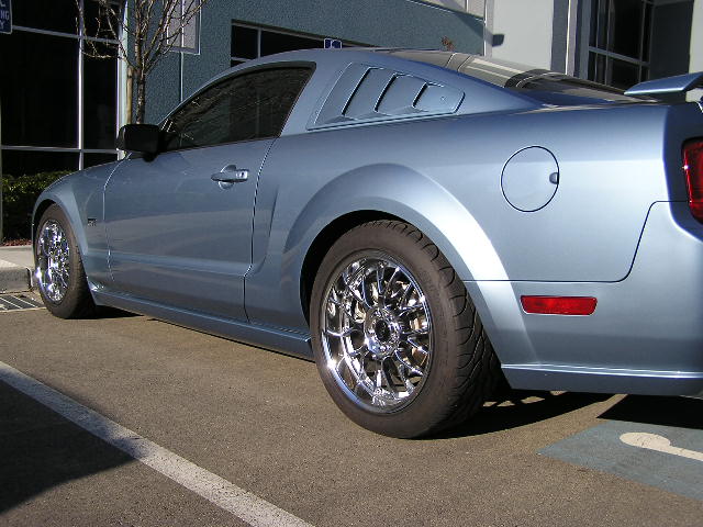

I was thinking the same as you, I paid $1130 for the complete FPRR kit. I really am enjoying it but no question the ride is stiff, but that's what I wanted. I wanted to feel the road and be able to take the turns alot faster which it accomplished.
