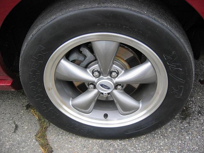

I have the ET streets on the stock rims and they work awesome, I have the 3743 biasply ones. You don't need screws. Use them at the track only and you'll be fine.
I've run them on both the bullitt and upgraded machined wheels

Yep, I'll be going with the 3743s. I need to find some 17" stockers though. What about a front setup? What size tire/wheel?
