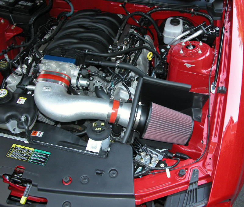

Here's a pic of mine. Had to off-set the "tube" just slightly, to clear the coolant tank.
Also, I just replaced the vent tube with a hose, not pretty but effective.

yea looks like i'll need to get a new PVC vaccumm hose. any one know what size to get? can these hoses be found at home depot or lowes?

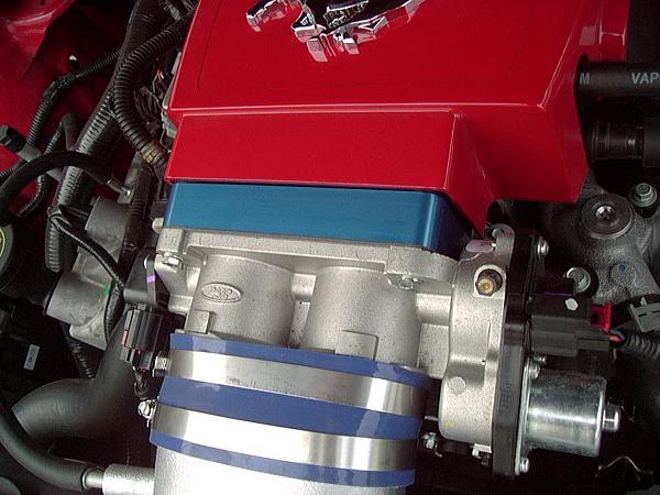

I was able to install the C&L and the TB spacer without any problems. The fit is tight. I was able to use the vacuum hose that came with the car. It's stretched tight but it snaps solid into place.
A few clearance problems to be aware of; check the clearance between the C&L and the following components:
1) radiator overflow tank
2) Power steering reservoir
3) radiator hose underneath c&L
The best procedure I found is to install everything and leave all the clamps loose. Move the C&L so that you have some clearance between all of the componets listed above and then tighteten all the clamps. The entire install takes about 15minutes.
