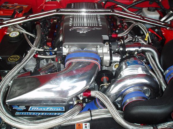

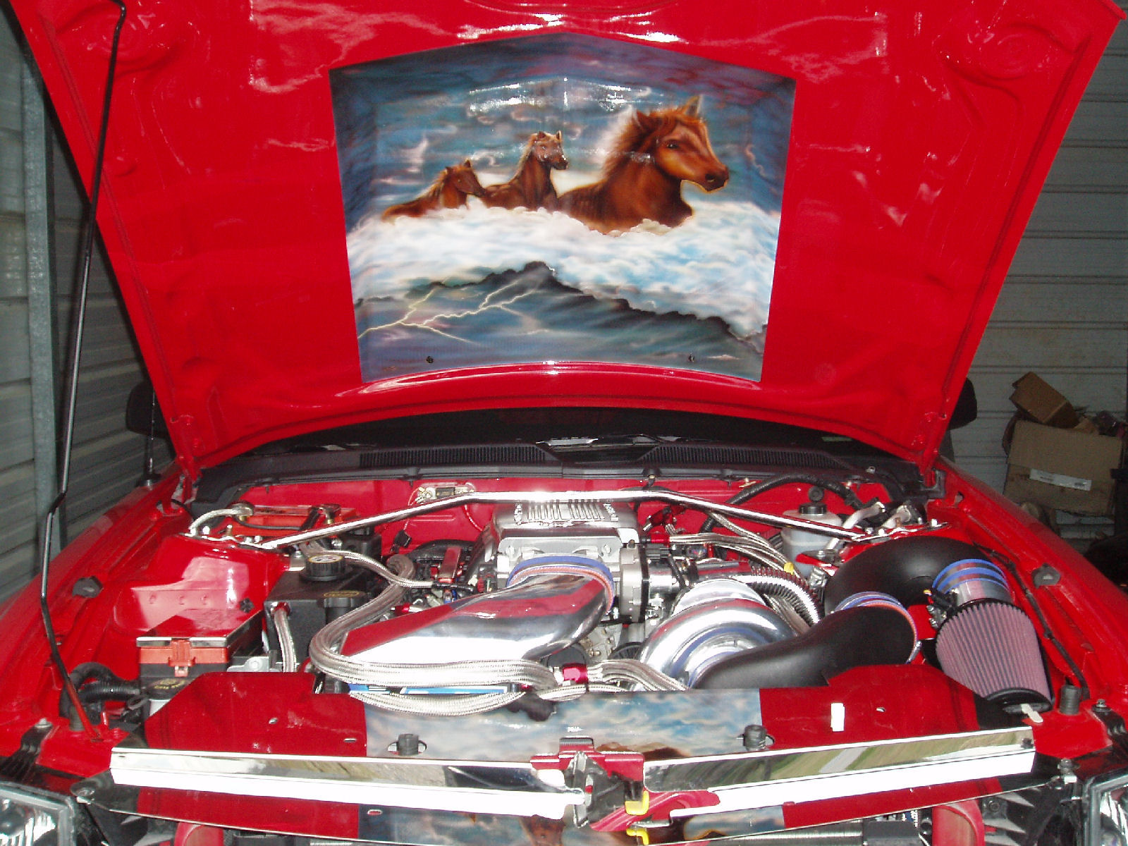

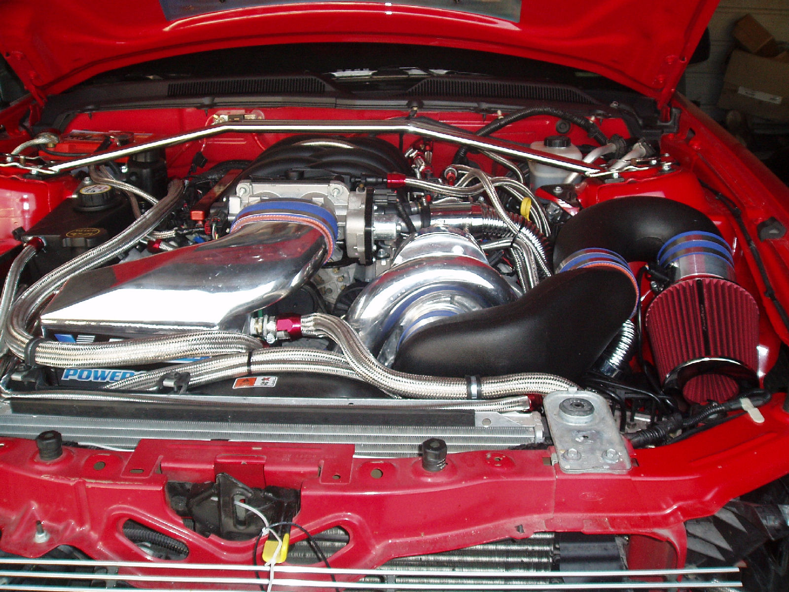

Good luck on your engine dress up, I replaced all my radiator hoses with Spectreperformance Magna Cool series hoses, the hose material is a rib design and it can be bent in any formation , you just got to take your time and it can be routed in just about any form.If you click on any of the pictures and then maximize it ,you will be able to see it better.
Attached Thumbnails Braided Hose Problems!-vortechdyer4-018.jpg   Braided Hose Problems!-spectrenew-001.jpg   Braided Hose Problems!-vortechdyer50.jpg
