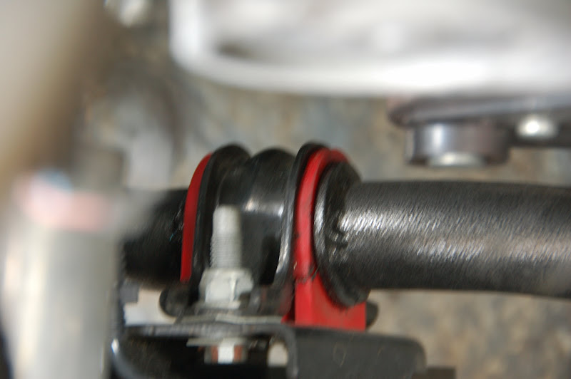

Need help on how to make this stop. A couple nights ago I started hearing a nasty clunk from the underside of my car. Today I put it on jackstands looked underneath and the first thing I saw was that the BMR front swaybar could slide side to side through the bushings (which are heavily greased, but I don't remember doing that when I installed it). The stop rings (seen below towards the 90 deg bend on either side) are basically hitting the mounts causing the clunking as the front suspension travels irregularly. Any ideas on how to stop this?

Maybe my bar is defective, the stops have almost an quarter of an inch of clearance between the stops and the mounts. I'll try to post a pic as soon as I can.

It sounds like metal hitting something and I can feel it through the floor pan. kind of a deep metal "thunk" or "clunk". Only seems to do it with sudden changes in directions or going over bumps in any other way than straight on.
Here are the pics. The first one is of the passenger side:

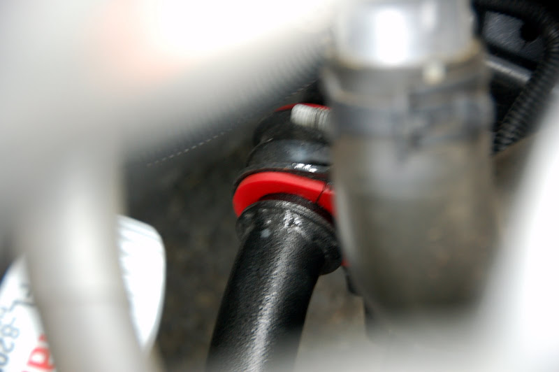

And of the driver's side:

I also have a clunk, and took a look and have the same issue, the lip on the swaybar allows room for it to move side to side (doesn't rest against bushing). Let me know what your solution is.. I'm quite P.O.ed to say the least.. I already had the BMR LCA bushing problem, which they did take care of, but a street car should not be having so many issues.

I took the car to the dealer for the 30k service ($$$) and they said the swaybar endlinks were loose at the struts by about half a turn on one side and one and a half turns on the other. They tightened them down and it hasn't been clunking since. But its only been 1 day.
BTW, the tech didn't seem too terribly concerned about the collars not resting against the bushings, thought there usually is some play on it. I don't remember that being the case on the stock unit but my thoughts as to a solution are to get a set of wider bushings
