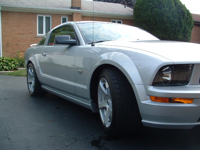

BMR SP009 springs installed here... I think they look good, AND they perform well...

MIne is a daily driver and will never see the track. How is the ride on normal roads? Tokico D-Specs also I assume?

I tend to like a firmer ride, but with the D-Specs dialled down to around 5 turns out, the ride is quite compliant, perhaps even a touch softer than stock. They are a variable-rate design, so they tend to be softer under lighter load, but get down on them, and they tighten up nicely. If you can find somebody with them to take a ride with I would strongly recommend giving them a chance. They are NOT uber-stiff track springs.
