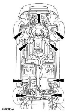

added PDF file
Originally Posted by IsaaX
I did a search but did not find a write up on anyone installing a adj panhard rod themselves.
I'll do a write-up later on Leo06GT's Steeda adj. panhard bar and lateral stiffener install.
In the meantime, here's the PDF document from the service manual. Attachment 38376

(I don't know your level of mechanical expertise and I'm sure you're smarter than this --but I wasn't) DON'T LIFT BY THE DIFFERENTIAL CASING. VERY BAD.
I hate to bring this up again, but why not??? Every mustang I see at tire shops is being raised that way. I have yet to see one lifted on a 4 point lift or a ramp lift.
If im not correct, i think the only reason the manual states not to lift from the casing is because it allows the car to move. (incase you dont block the front/rear tires).

As long as you're careful not to touch the differential cover, there is absolutely nothing wrong with jacking the car up by the "pumpkin". The reason the manual states not to do so, is because Ford used a flimsy cover, and they don't want you catching the cover on the jack and creating a mess.

I lifted it by the diff and it slipped off the jack, wrecking my diff cover, panhard rod and lateral support. I found it was cheaper to replace the stock pieces with Steeda bits (hence the saying in my sig "...it's cheaper to replace it with performance parts"). I was **** lucky I was smart enough not to be under the car when I was lifting it or it would have been a closed-casket funeral. Whether or not the cover can handle it (which it can't if you make a mistake) and regardless of how sturdy the actual steel housing is, its a small, curved, relatively slippery area to jack from, and not exactly solidly mounted to the car (that whole suspension thing). Plus, do you really want your rear-end balancing on the jack? And yes, it was a level surface;yes, I did have the wheels chocked; yes I was taking it slow; yes it was a real floor jack I was using, and no, I couldn't fit the jackstands under there yet when it fell. DON'T LIFT BY THE DIFF. You can lift from anywhere on the pinch weld, from the chassis-side LCA mounts, the K-member, etc. So many lift points to choose from, why take the risk?
