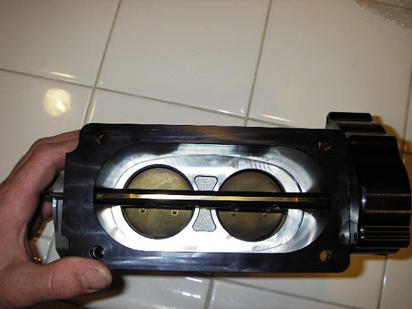

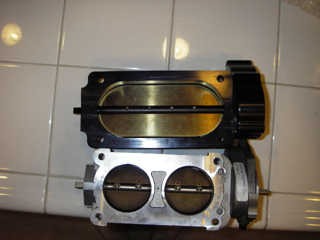

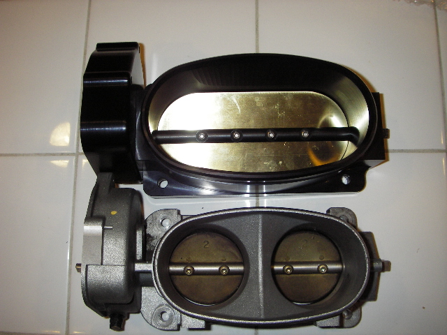

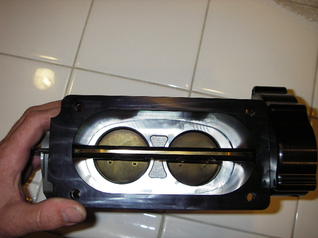

Here are some pics of the TB with the stock TB INSIDE IT...
Attachment 31734
Attachment 31735
Attachment 31736
Here is a dyno run of my car so you can see what the intake set-up looks like...
http://smg.photobucket.com/albums/v6...T9Aug07005.flv
Attached Thumbnails BiggestThottle Body-monster-tbody.jpg   BiggestThottle Body-monster-tbody2.jpg   BiggestThottle Body-monster-tbody3.jpg

Originally Posted by INTRUDER
Thank you for the info...
Can you give me the link?
You caer lloks and sounds great!!!
any other suggestions ?
Thanks. The TB/intake was the key to getting over that airflow wall that you WILL come up against when you start breaching 600. ST motorsports (spankintime.com) link is in my sig. Give the shop a call for more info.
Other suggestions - for where you want to go, the tru track and the stock trans manual or auto is not going to cut it. You are going to need a locker, beef up your rear, and look at some high performance trans options like an AOD or C4 IMO.
Getting the power is easy step 1 - hooking it is step 2 and the most important. I'm sure you're also going to need some other goodies like the older version BMR extreme anti roll bar welded in, some upgraded/solid brackets and a beefy rear end bushing. Good axels tube welded, girdle, good drag CA's like the metco. Maybe a coilover set-up as well.
