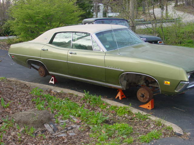

What? bigger brakes? These have worked fine since 1970

Live on rusty drum brakes!
