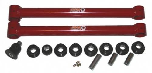

I am looking into buying this pak as my wheel hop is getting on my nerves.
Anyone here having live expirience with Steeda's 'stop the hop' pak?
Cost: $300.00 plus shipping.
I've read in a recent post, that the FR package is crap and does not stop the hop, so I was wondering about Steeda's. Just don't want to waste money.
Thanks for your input.
Ralph
____
Here a picture:

I don't have that "package" but I've had those lower control arms for over a year now (almost 2 years actually) and they eliminated 99% of my wheel hop. I bought them from Brenspeed for like $200 delivered back then.

I don't have that package , but I do have their billet lower control arms and relocation brackets and they definitely helped with the wheel hop. I will probably add the upper 3rd link control arm later ...

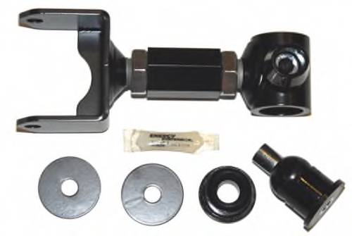

Many cars don't have a wheel hop issue. My auto vert never had an issue. My 5-spd coupe had only a tad of an issue which was stopped by LCAs, lowering springs, and a Panhard rod. They were all installed together, so I can't say that just the LCAs will do the trick. I know the upper mount and solid lowers is the way to go if you want less NVH. You will also be able to modify the pinion angle and I think that is what really "fixes" the hop.

You may want to get the adjustable uca instead of the fixed one so you can adjust pinion angle. You may need to if you lower your car or get a driveshaft. Also if you lower your car you should get the relocations brackets or you will be spinning tires a lot.

I have those exact lower control arms. They completely rid me of all wheel hop. I would also suggest going with the street adjustable upper third link instead tho. If you're gonna bother changing it might as well get one that will allow you to adjust pinion angle.

Personally, wheel hop increased after I lowered the car. That's why I will be looking into an adjustable uca, solid lca's, and relo's. I felt very little wheel hop with 100% stock suspension. I'm using a manual.
