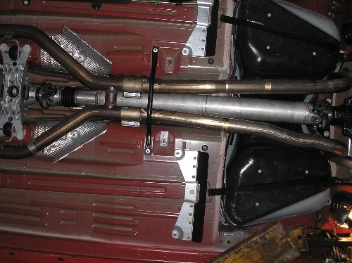

http://www.lmperformance.com/5996/73.html
As you can see, rust is starting to set in on the stock driveshaft. I don't mind the 2 piece setup that much as it should reduce the vibration/wobbling at high vehicle speeds whereas a single piece shaft will have to handle the driveline angle all by itself. I just wish Ford used an aluminum material for the stock driveshaft. Ford always skimps out on the small details.
