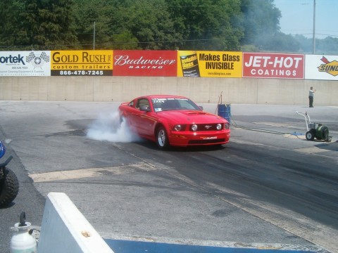

Originally Posted by Rebel73
Are the one piece an issue on lowered cars?
it can be if you have stock LCA,UCA's and are lowered more than 1.5". i did have a rub when i set my car down in the weeds. i got a good UCA and raised the car up a little. as you can see it's still low.
