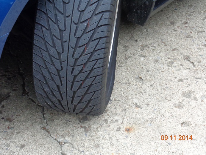

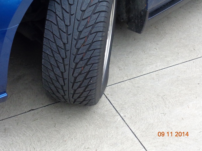

just tried something too- cut the wheels hard, drove fwd, took a pic. reversed without changing the wheel angle took a pic... driving forward, the tires tuck under hard, driving backwards they spread way out - as if when cut hard, they have a substantial toe in due to poor ackerman geometry... any way to correct this by shimming the rack, stiffer front lower arm bushings, or ?
my old F150 had this same issue- severely- even when new, my mark VII had it too, even after all new frontend- think maybe Ford just isnt real careful with Ackerman/rack width... at full turn, the tires just dont quite track with the wheelbase

Could be something worn. Still the original control arms? That giant rubber bushing on the rear mount is probably the first place I'd check. Might not hurt to look at the ball joints too.

all original, I checked everything in the spring when the last tires were wearing, balljoints tight, bushings look good (all 3 of our cars show cracks in the rear bushings, but they are centered/tight if pried on)... gonna check again this weekend, probably have the alignment checked again- just thinking the wider tires might wear better with a little toe-in and maybe a little less camber- just the sawtooth cupping I would think is more from toe out/scrubbing than rolling on the inner edge from camber- but then too, both sets that started cupping had the curved tread blocks, they may tend to squirm more angled than a block tread...just still my gut feeling is a little toe-in should help even it out.

checked out the frontend, everythings still tight... went ahead and tried toeing it in (went 3/16 at the tread diameter), the slightly cupped tires were howling like crazy, almost quiet now... I flipped the tires from right to left (directional- have to remount) last time and they went totally quiet, no doubt that should help again, as they arent nearly as bad as last time, time will tell if the toe-in helps with the tire wear... if not will pull some camber out

Typically cupping is due to worn suspension parts. Visually the struts may look ok but they could be bad and a visual check will not always tell you what is wring. Jack up the front and manually turn your wheels side to side if you get play most likely inner or outer tie rod. Up and down play most commonly ball joint or control arm bushing and if your car is lowered it may feel like the struts are tight but they could be blown out
