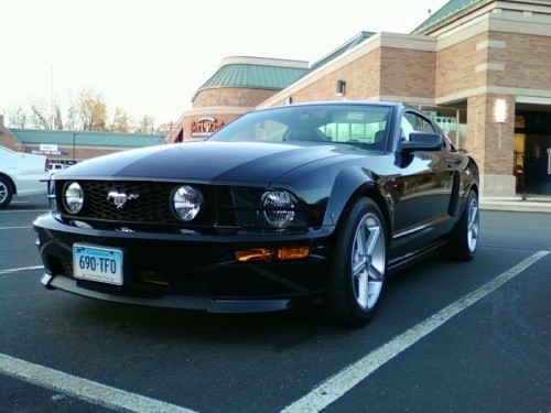

I had 295 35 on 9 inch rims and the tire looked pretty good to me.... but from what I have read that was to wide for a 9 inch rim. I think 275 would be to much for a 8.5 rim.
This is a 255/35/20 on a 8.5 wide wheel
I think it looks pretty good on there.
