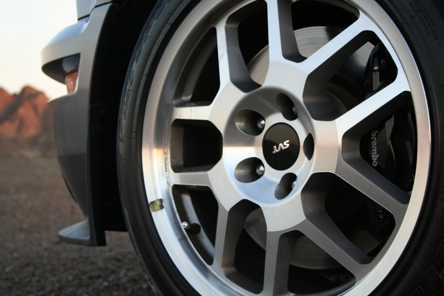

wouldn't trade these babies for the world
i love the look and stopping performance
Attached Thumbnails 14" GT500 brake fitment...-img_0882.jpg   14" GT500 brake fitment...-img_0850.jpg
