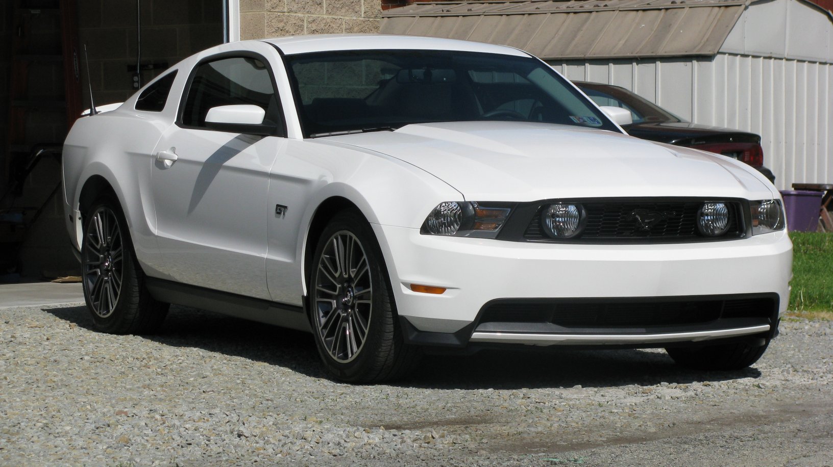

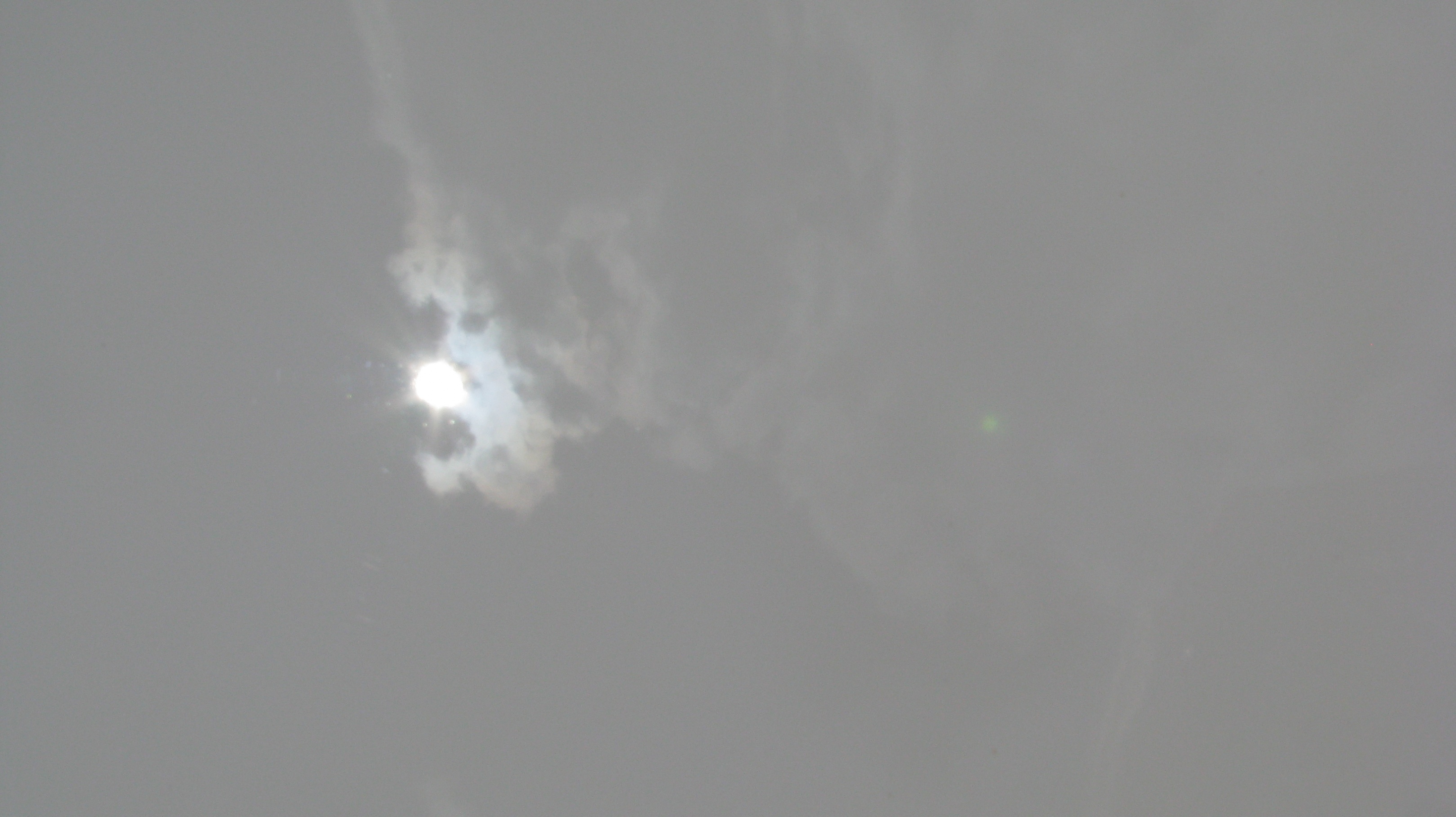

Sun showed it face today.
Pic 920 is where I did the "3 Step".
Pic 918 is good representation of the rest of the car.
Maybe I'm being to particular.
Let me know what you think.

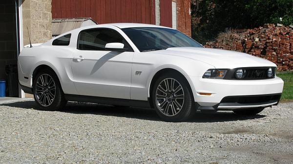

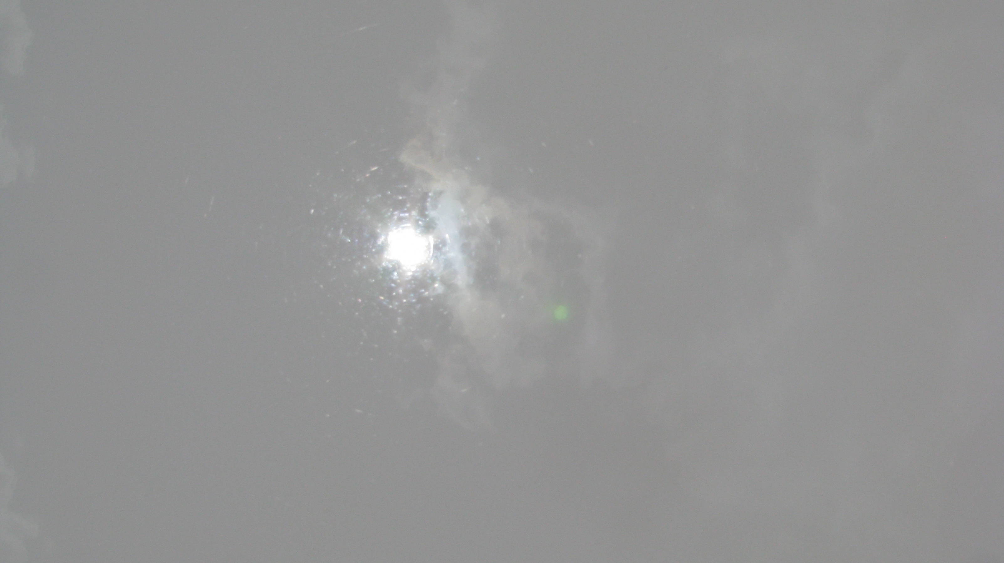

But in the mean time, I'd thought I'd share these also! I'm very impressed with the Mothers wax
Attached Thumbnails What went wrong?  Mothers 3 Step-img_0922rs.jpg   What went wrong?  Mothers 3 Step-img_0923rs.jpg

Actually, it came out that way (pic 920) after doing the 3 step process. It originallly looked like pic 918.
