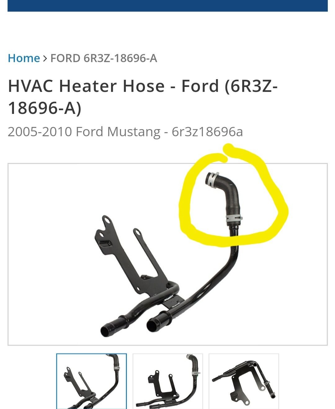

Help finding a hose

Easy Deal!
OP, You Indicated You Wanted Just The Hose not the Pipe in Another Duplicate Forum! I should Have Answered There But Now It's Done! As Far as The Leak if It Persists after Replacing Hose Your Just Gonna Have to Look Closer and find That Leak!
The Cut to Fit Option is Listed at Rock Auto. It's Simply a Same Diameter Elbow Hose You Cut Down to Size and Install. Your Old Hose Taken to a Parts House Should Be Able To Match as Well! Just Find the Experienced Counter Person Not the One Flipping Burgers Last Week!
They Can Also Get the Gates Number and Try to Cross Cross Reference it if They Don't Handle Gates!
Ford Only Sells Complete Assembly. Just Look For the Elbow And Correct Diameter & Disregard What Can Be Cut Away! Thats How We Did It Old School When a Hose Went Obsolete as Well! 5/8 Heater Hose Elbow Should Be an Easy Deal!

Thank you. Yes, I realized after posting on the car care forum that i was on the wrong one but didn't know how to delete it. Thank you again for the help.
