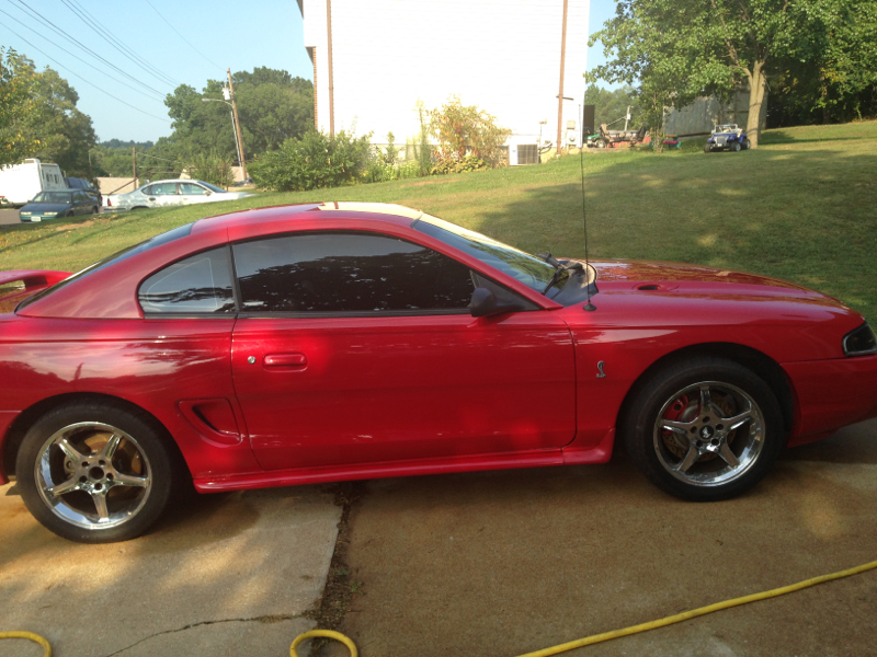

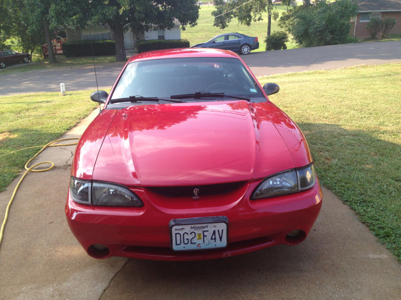

Well it took about 8 hours but I'm finally done, I stripped her with Dawn, dried, clay bar, washed with Megiurs Gold, dried and than waxed with Megiurs Gold carnauba wax and than polished the rims and exhaust tips. She looks GREAT!!! I will post pics tomorrow
Old Aug 24, 2013 | 08:26 PM
McNassty's Avatar
Joined: February 18, 2012
Posts: 622
Before pics
