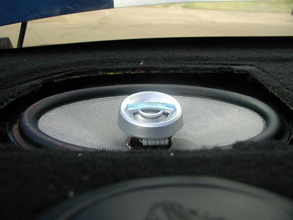

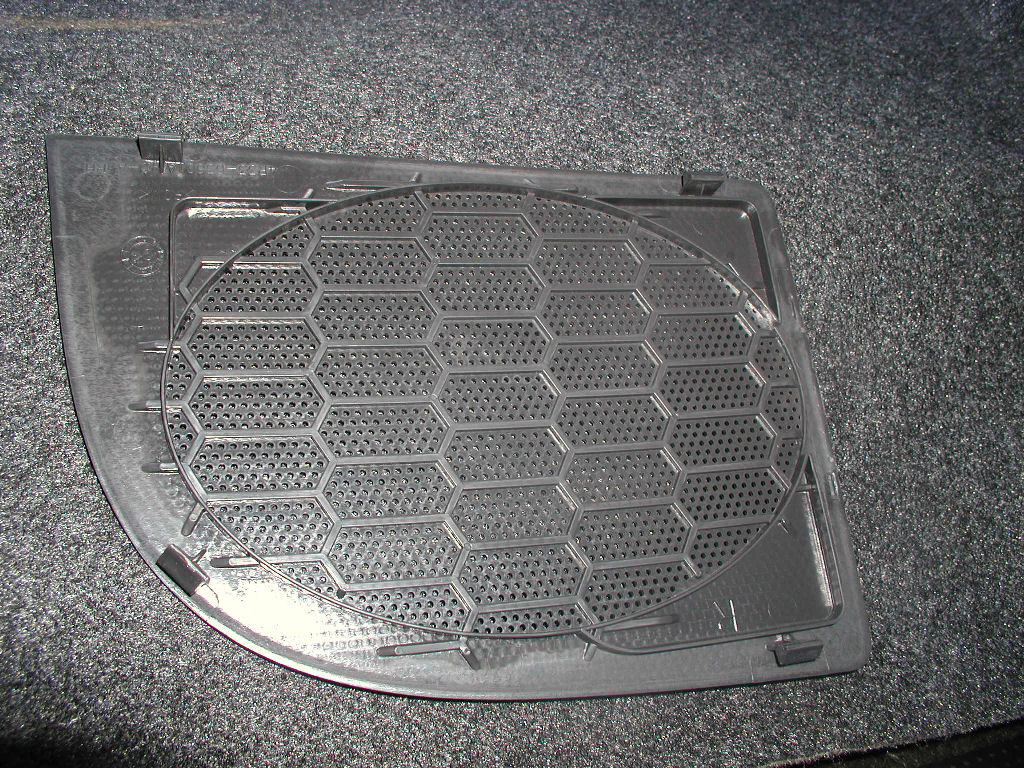

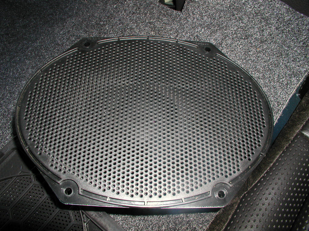

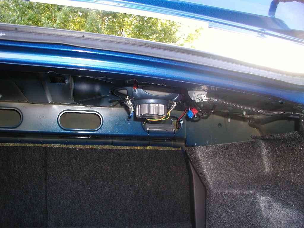

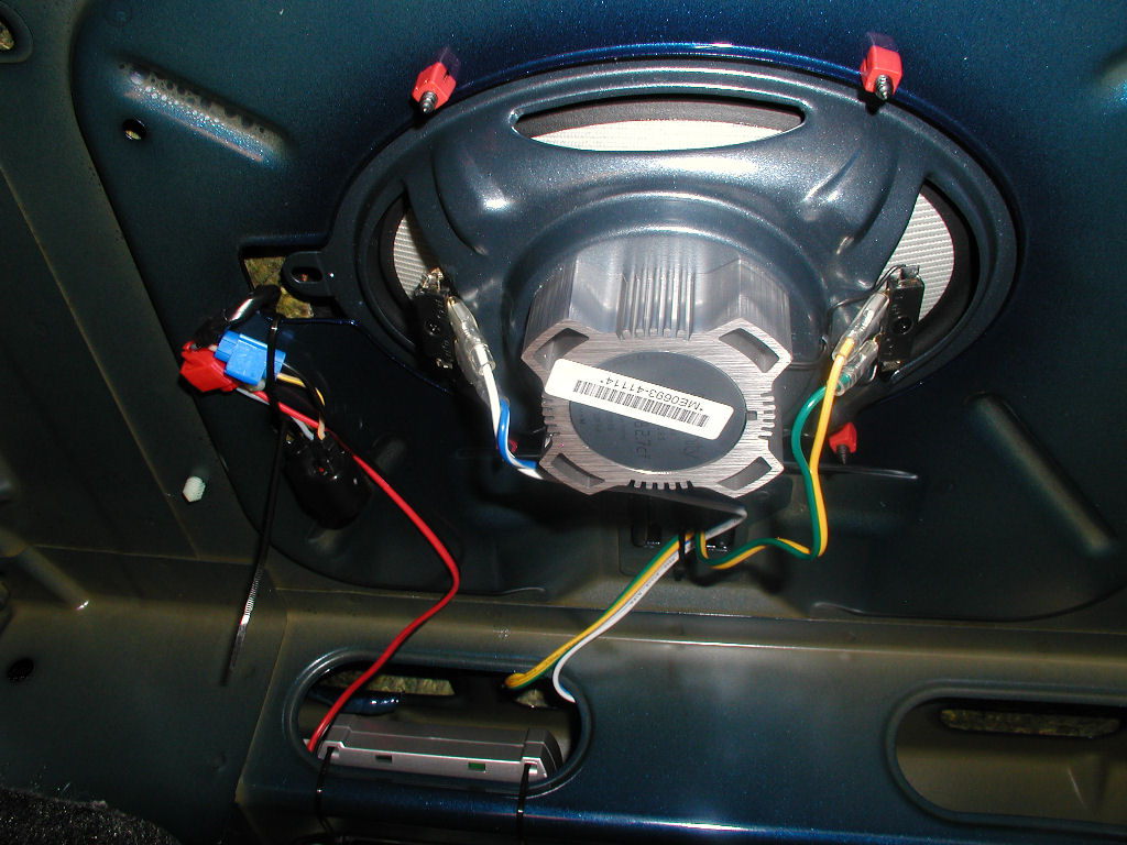

Infinity 682.7CF 6 x 8 Speaker Install - Rear Deck
Hardest part to this install was just getting the **** screws out of the stock speakers.
I folded the rear seats down, stuck my feet in the trunk and began the removal of the stock speakers.
1) Pried the Factory Speaker Cover off with a Flat blade screwdriver.
Attachment 6412
2) Unscrewed the (4) T20 Screws holding the speaker in.
3) Unplugged the factory speaker and removed it.
Attachment 6413
4) Positioned the Infinity Speaker and replaced the (4) T20 Screws
Attachment 6414

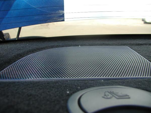

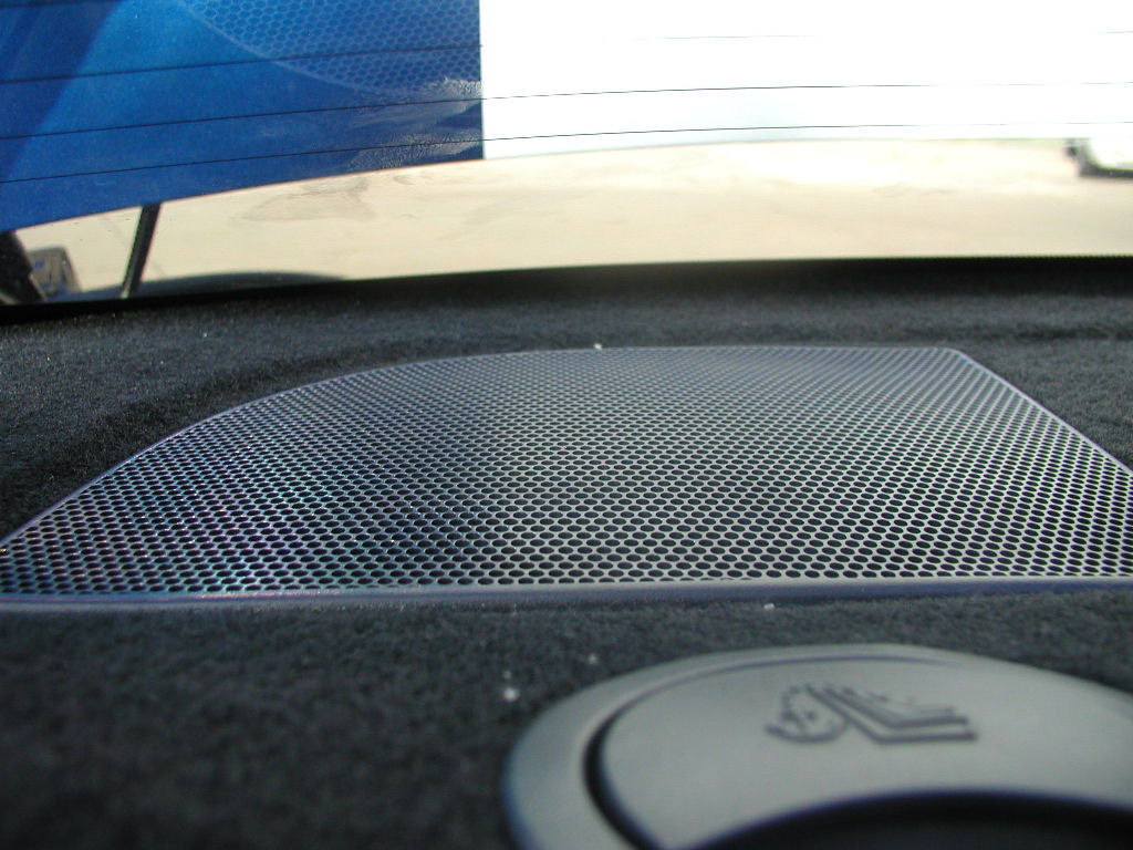

5) Replaced Speaker Cover (Can't tell it isn't stock speakers from the top)
Attachment 6415

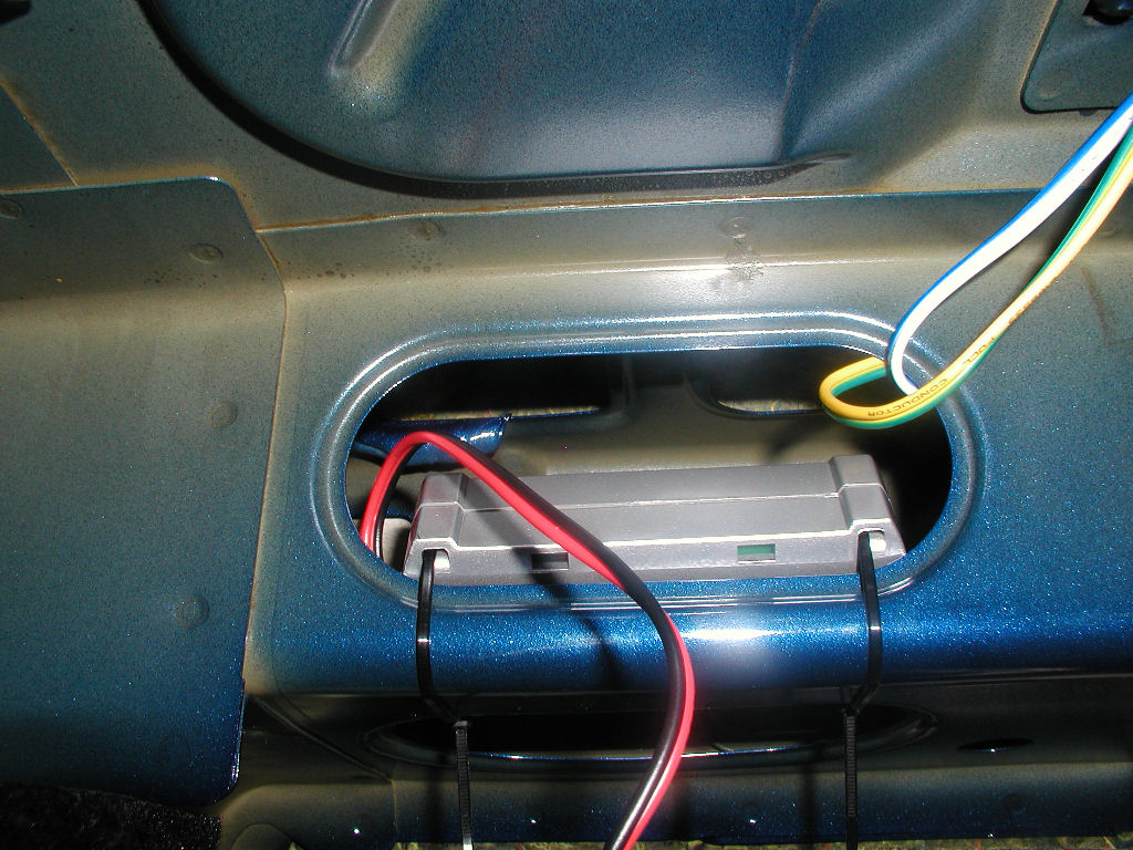

6) Since I could not find the speaker wire harness, I tapped into the stock wires using the taps I used on the DRL Install.
The crossovers were no brainers as the connections were different sizes so you really can't screw that up.
7) Cable tied the Crossovers to about the only area I could find that was out of the way, but still left you room to actually tie it down.
Attachment 6416
Once I get the wire harnesses, I will install them and clean the wiring up a bit.
Next post has a couple more pics.

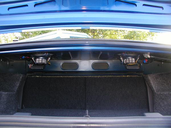

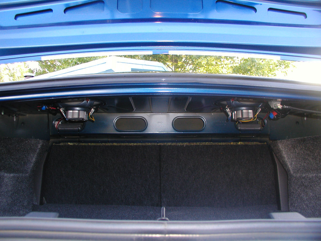

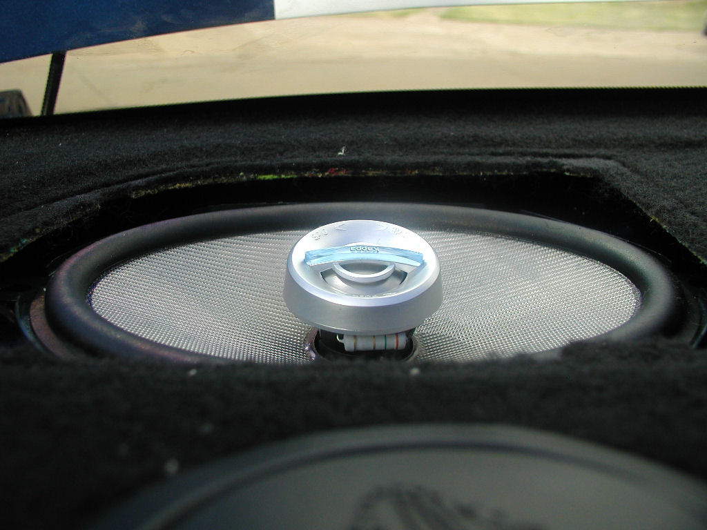

Infinity 682.7CF 6 x 8 Speaker Install - Rear Deck Pics
Install Complete Pics
Attachment 6417Attachment 6418Attachment 6419
I can definitely tell the difference between the stockers and the Infinity's especially when you crank it.
I also found that if I place the sound field option to REAR SEATS, it rocks the house like crazy !
Attached Thumbnails Ponies on The Run!-infinity-682.7cf-rear-install-complete-1.jpg   Ponies on The Run!-infinity-682.7cf-rear-crossover-1.jpg   Ponies on The Run!-infinity-682.7cf-rear-install-complete-4.jpg

Well the tops have a permanent grille on them, or at least tight enough I wasn't fooling with taking them off. But they are the cheap *** paper crap speakers you would expect for factory speakers.

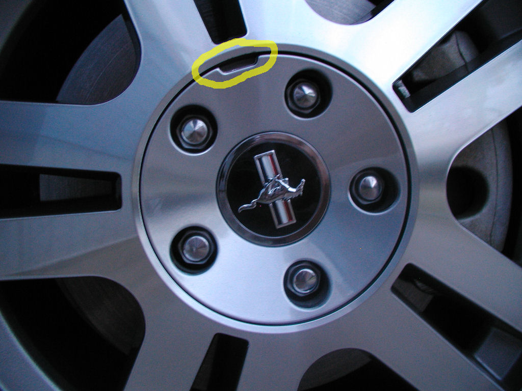

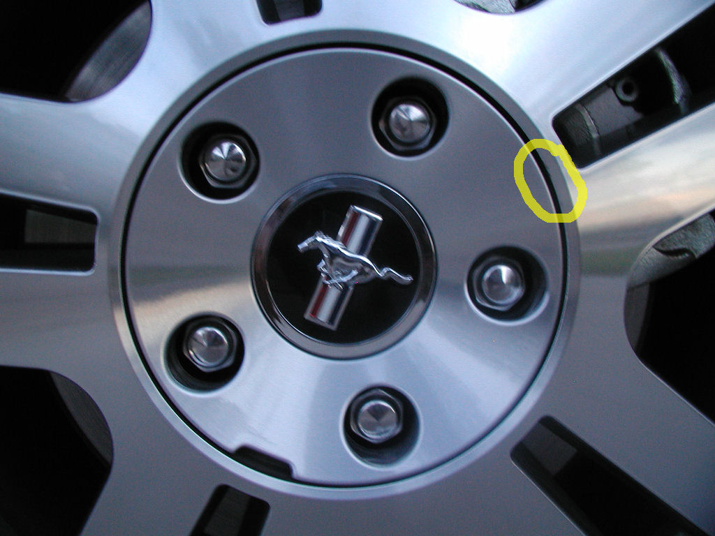

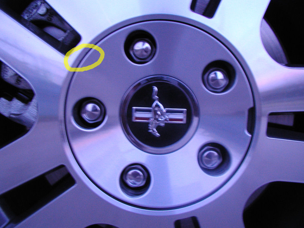

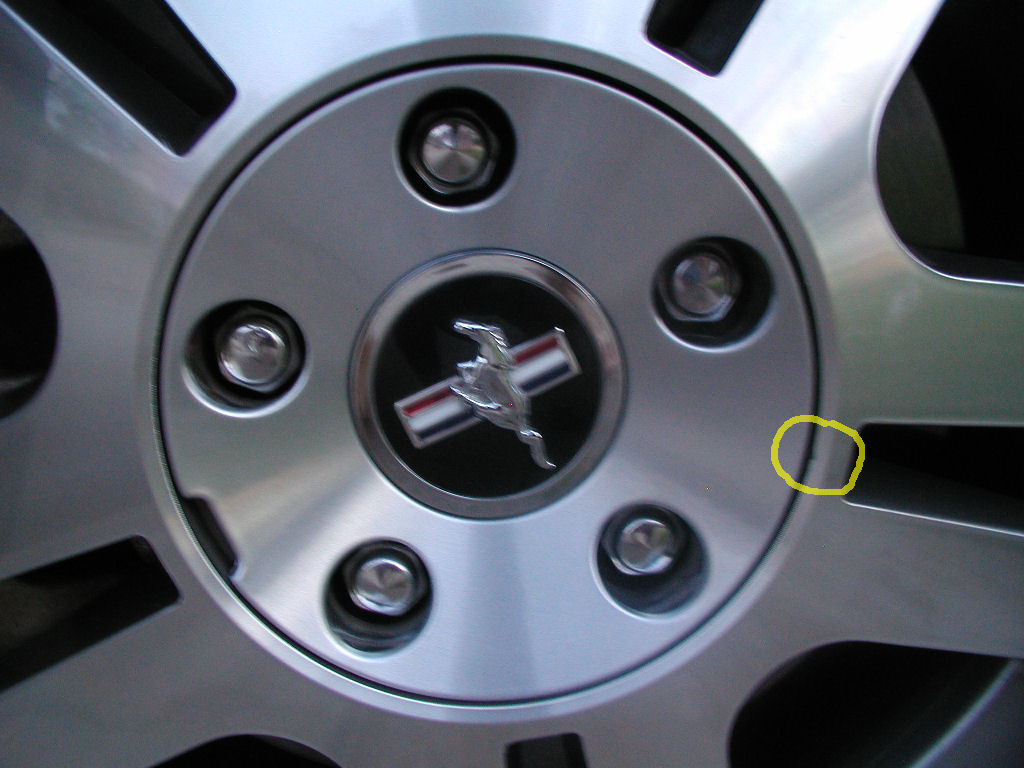

Ok Here are the Pictures. Post your Opinions, am I being picky or would you be pissed too ??
Front Driver Side
Attachment 6425
Rear Driver Side
Attachment 6426
Rear Passenger Side
Attachment 6427
Front Passenger Side
Attachment 6428
Okay, here's my $.02...
Even though it doesn't look devastating and all (even though it feels like it), I'd still be upset at that mechanic. I don't care if the wheels cost $10 or $1000 each, care and respect should be given to each and every car that a mechanic works on.
Here's my point, if I knowingly caused those burr marks, that's something I can accept and live with. But if someone else caused them... I be fumin'!
From your pics and descriptions of the whole ordeal, I have lost faith with that service department. For one mechanic represents the whole service department.
I would attempt to repair those burr marks myself. Maybe use one of those 'soft' deburring tools (hand or Dremel) and tool those areas so they blend in. Like I mentioned earlier, I would not let them attempt a repair on them.
So, Daryl, to answer your question, are you being too picky? ABSOLUTELY NOT!
