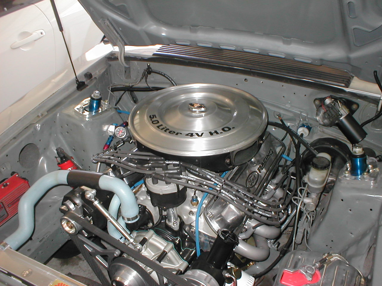

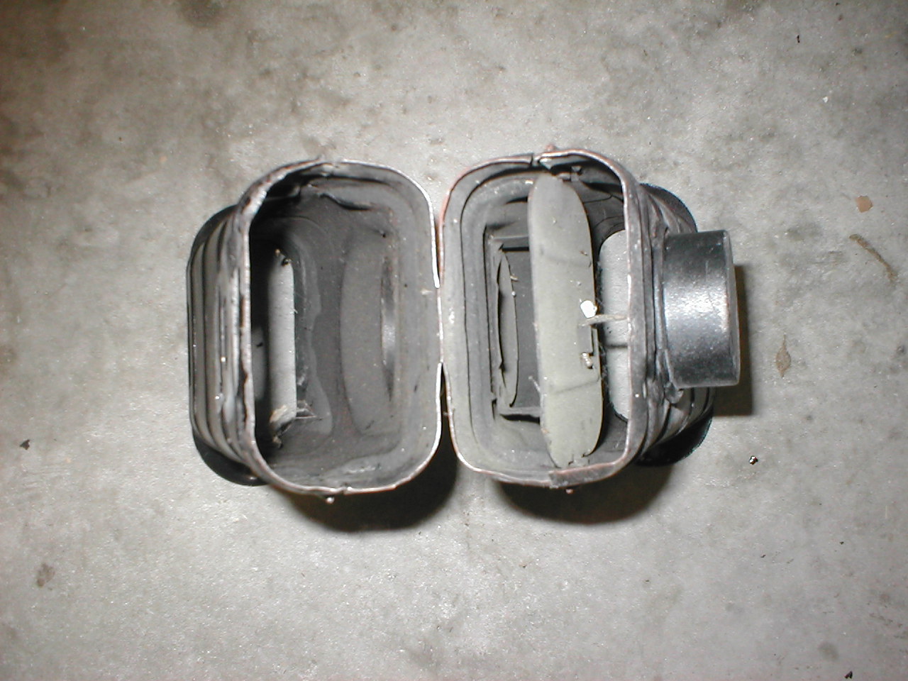

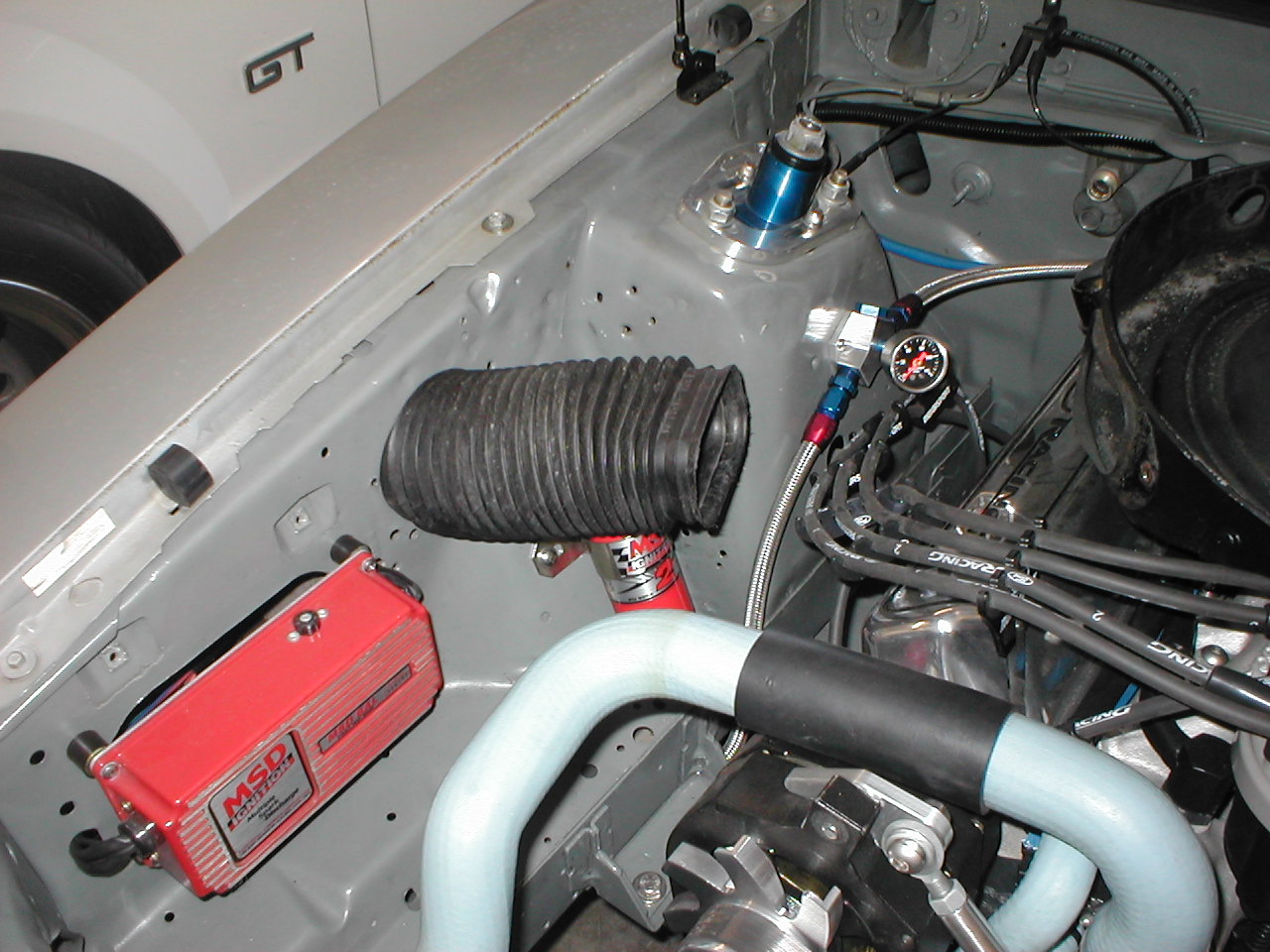

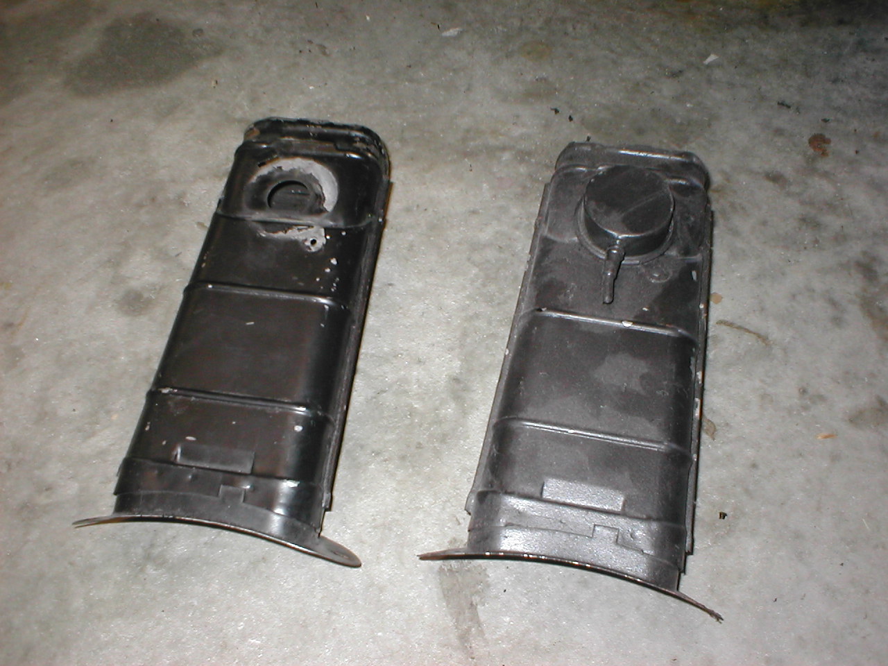

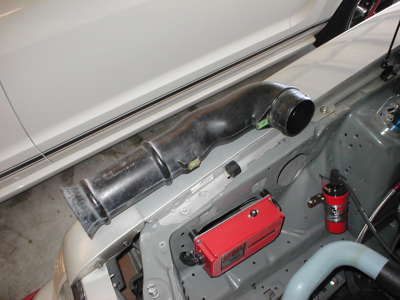

Got my 1983-85 Dual Snorkel set-up yesterday and I started playing around with it today. The hard part would be to get the tubes into the fenderwell, but they are too long anyway since my front fascia is different from a 1985 Mustang. I could shorten them and still mount them, but as long as the flexible tubes suck air from the fenderwells it will still be cooler than air from right over the engine, so I don't think I'll use the tubes that go into the fenderwell at all.
On CarCraft.com, they hooked up an air temperature probe and air going into the carb was 20 degrees cooler when using this set-up versus just an open air cleaner. That's a big difference!
Everything is in pretty good shape for being 21-23 years old (even though everything has to be cleaned up and/or painted). I did order new flexible tubes on eBay. The one was ripped at the end, so the new ones will look a lot better.
The hard tubes that come out of the air cleaner are in good shape. I removed the vacuum set-up out of the tubes that directed warm air from the headers during start up. I'll just have to braze up the holes.

Dang Tom, that engine looks sweet! And I bet it sounds pretty healthy too!
Bet it's nice to install whatever you want and not worry about emissions.

Thanks!... I'm sure you've seen my Photobucket page for the '89. There are some pics of the build process. Sound quality is awful in the videos... it sounds a little better in person!

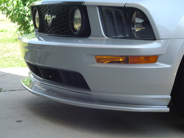

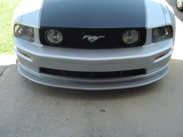

Installed splitter today.

Doesn't appear to be as low as the CDC Classic, so I guess it'll be more 'driveway friendly'.
