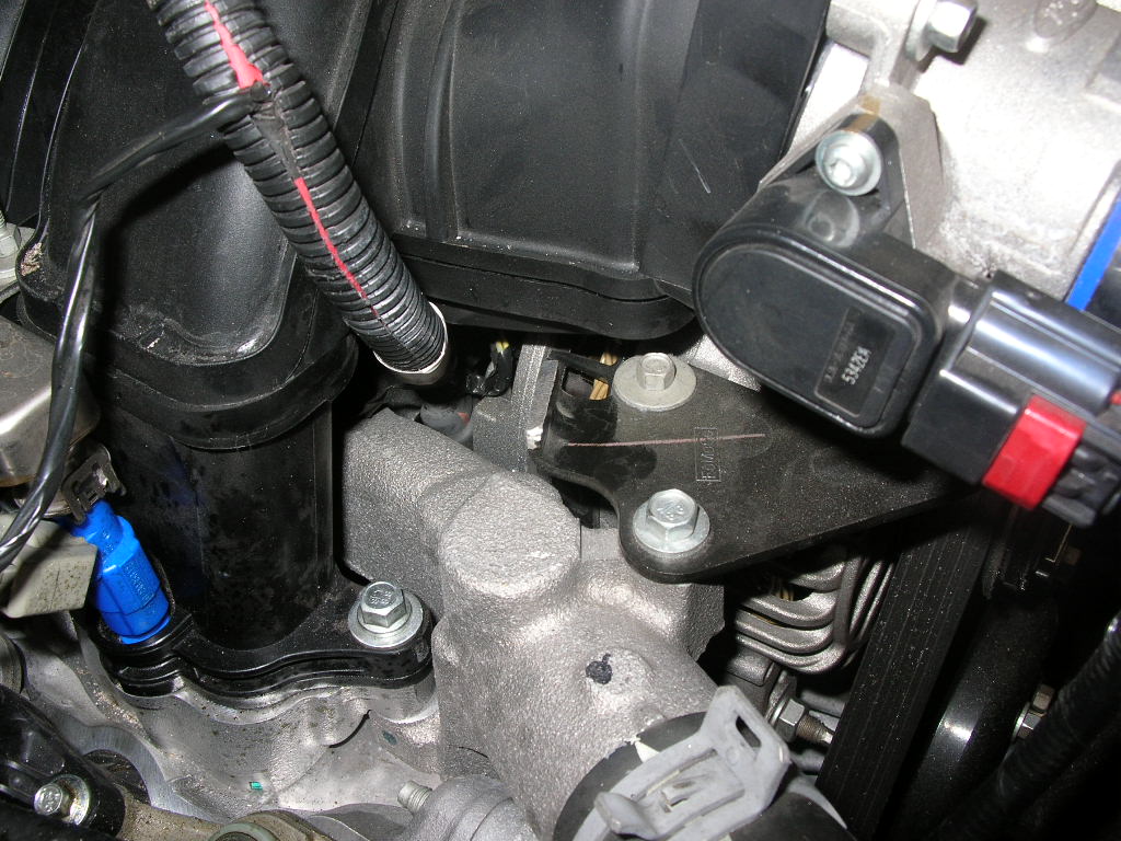

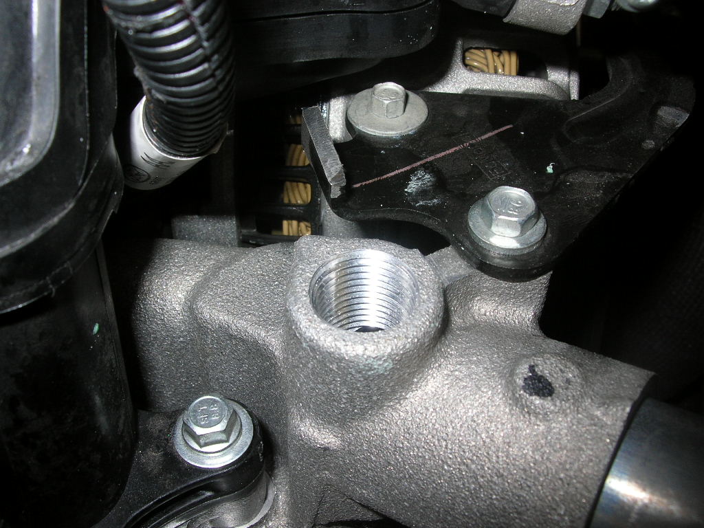

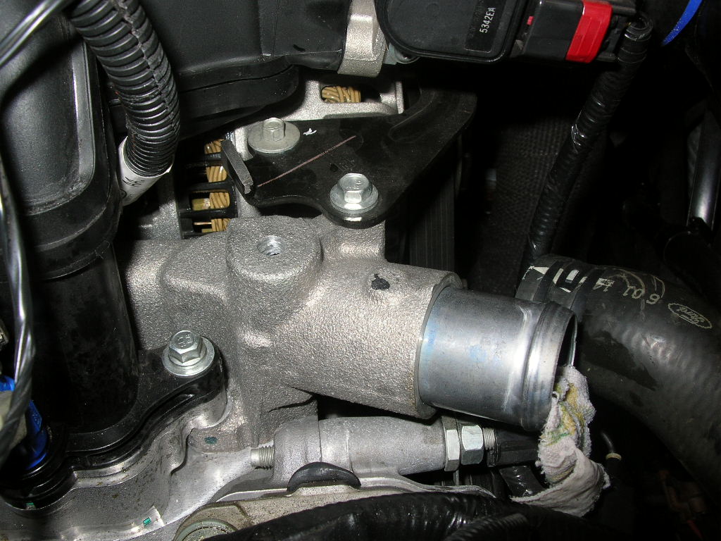

Here are some pics of the Mechanical Water Gauge 1/2" NPT fitting installed into the intake:
Attachment 40179 Here's the boss where the fitting will be installed. Should be very accurate since this is where hot water leaves the intake to go over to the radiator.
Attachment 40180 Radiator hose removed, towel stuffed in, and a small hole drilled. Grease was used on the bit to hold shavings, and a vacuum was used while drilling to suck in any loose shavings.

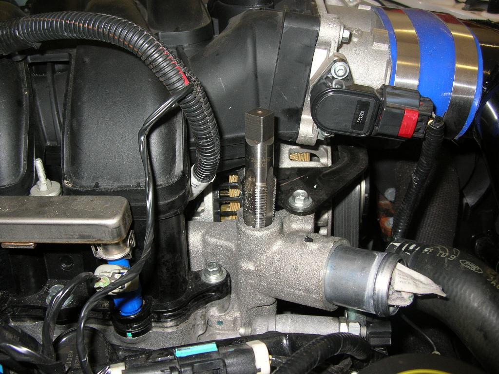

Attachment 40181 Here the hole was drilled up to 11/16" and a reamer was used to open it up closer to the required 45/64" hole.
Attachment 40182 With some Tap Magic, the aluminum is a piece of cake to tap. Looks like I got it fairly centered!

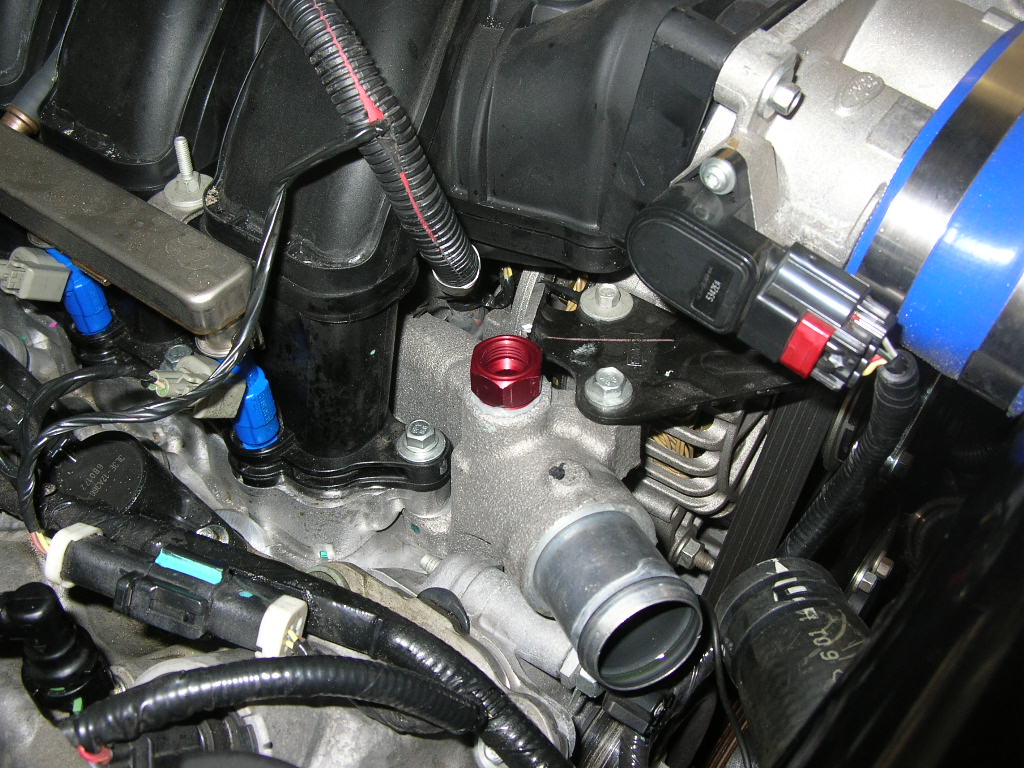

Attachment 40183 Here the 1/2" NPT fitting is installed with some sealer specifically made for coolant. Normally I would clean off the bead, but since the shaker covers it, I left the bead alone.

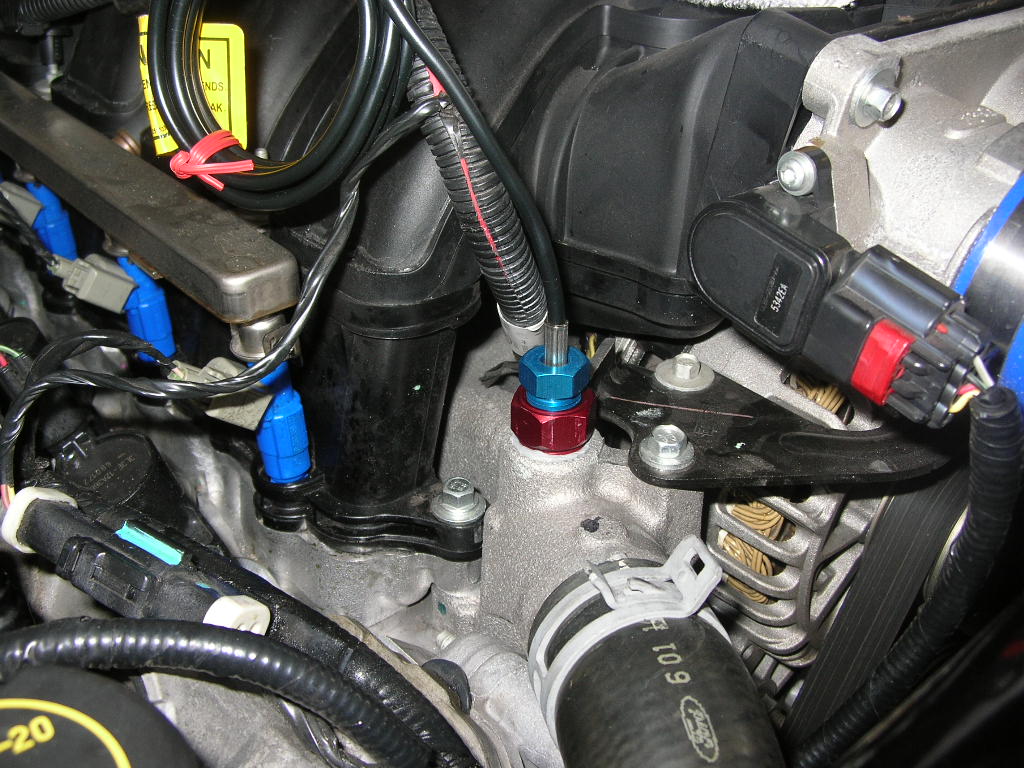

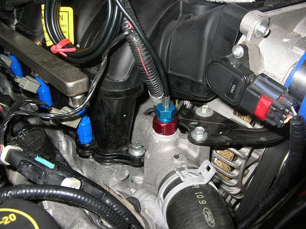

Attachment 40184 Second part of the fitting installed with plenty of room for the bulb to drop into the intake.

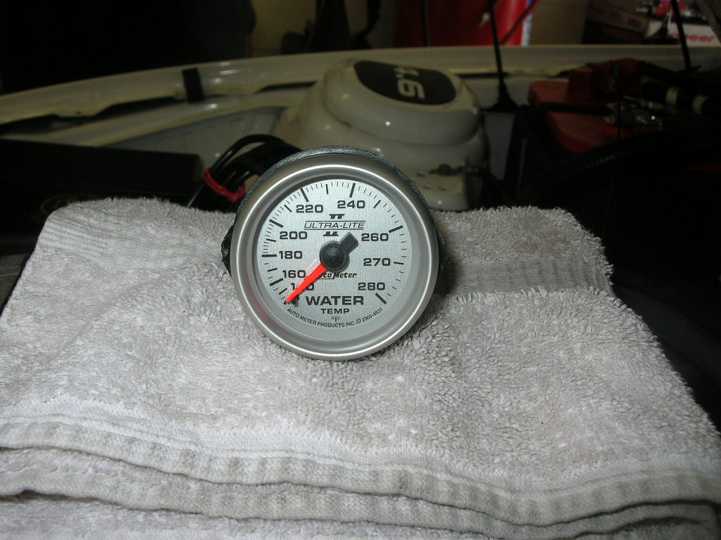

Attachment 40185 Here is the gauge. I didn't take a picture of it with the coolant hot, but fully warmed up it read 182°. I was told it would go up to 195° on the street. I'm returning this gauge and I'm going to get the one that goes from 120-240... that will put 195-200° right at the top center of the gauge.
