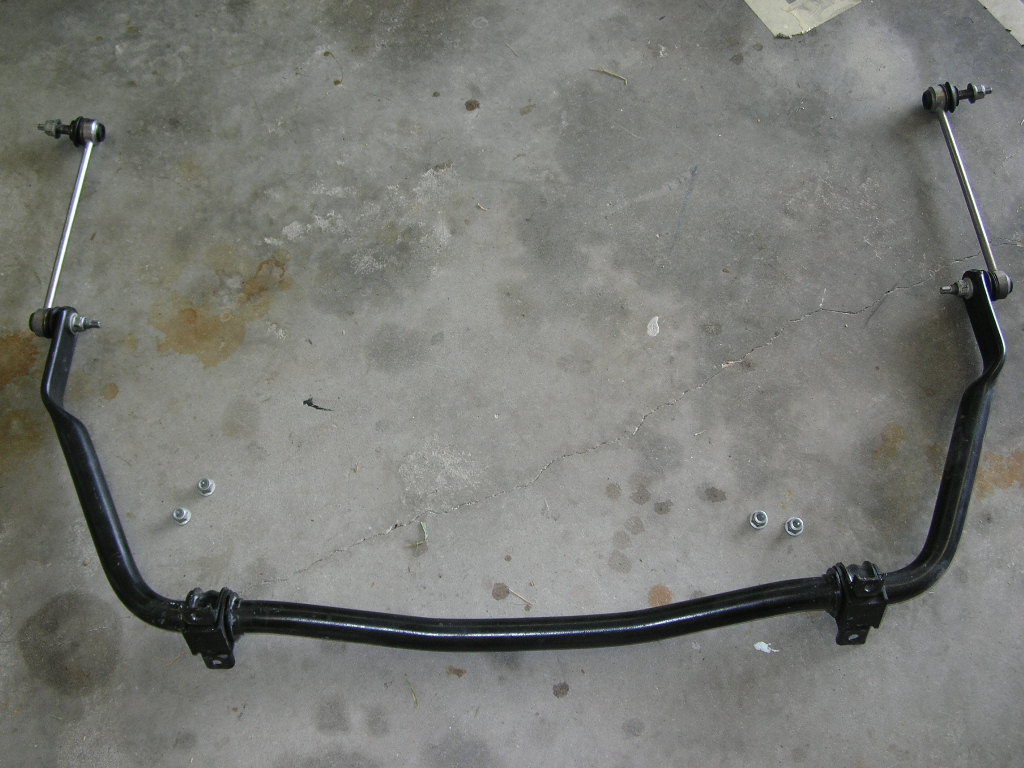

Due to the fact that I don't plan on ever doing any autocrossing or any "canyon-carving", I may be the guinea pig for this mod:
http://www.bmrfabrication.com/05Mustang/RS-1.jpg
I have a theory. I think that doing this mod will soften the ride up a little bit, or even a lot. If you think about it, every time the tire goes over a bump, it pushes up on the lower half of the strut assembly. Not only does it compress the spring and strut, but it tries to rotate the sway-bar. The sway bar reacts on the the other strut assembly and also puts force on the frame itself. All of this adds to the harshness felt by the driver. Now think if the sway bar was removed: just the strut and spring would be compressed and I think this would be a lot less harsh and will bring back some ride comfort.
To test this out, I'm going to remove everything shown in the link above except for the crossmember in the morning. If I see an improvement in ride quality and the car doesn't lean excessively then I might as well buy the radiator support for the weight reduction. Other people on TMS have this and use their cars as daily drivers and find there is not much body sway unless you are really carving corners (which I normally don't).
Another plus: Unless everything is dead on perfect, there will always be a pre-load on the sway-bar caused by the sway-bar links. This leans the body when the car is standing still and also affects turning. No sway-bar and no sway-bar links = no pre-load.
More info can be found here:
http://www.bmrfabrication.com/2005MustangCHASSIS.htm
If you plan to drag again, Leo, here's almost 30 more lbs off the nose! From BMR: The factory radiator crossmember is built overly strong because it must also support the additional loads of the front sway bar. With the swaybar removed, the crossmember only needs to support the weight of the radiator. Our lightweight crossmember only weighs 5.5 lbs. as compared the OE 16.5 lbs. Combined with sway bar removal, expect a 26.5 Lb. weight reduction!
$149.00 with free shipping.
Found this from a daily driver on another forum:
My sway bar has been off for 4k miles now, I still go through corners pretty hard. I push my car to its limits in the curves before and I haven't had to alter my driving for not having the sway bar. Yes it does have a little more body roll, I can live with it even going through a 35mph posted curve at 55."

Well, it's off:
Attachment 14639
I didn't even have to jack up the nose to take it off, either. I turned the wheels all the way in one direction and I could reach the sway-bar connection on one side and the link connection on the other side. Then I just turned the wheels all the way the other direction to finish. After that, I pulled it all out from the front. I'll let you all know how the car handles on the way to work today and if my theory is correct.
Tony - I never heard of that problem (or that fix), either.
I'm curious how it'll handle too. Keep us informed.

I did a quick drive around the neighborhood (turning through turns quicker than you should in a sub-division). I even did a U-turn sliding through half of it. I don't feel any difference in body roll.
I car pool today and I drive. I'll tell my friend to be on the lookout for something different about the car, but I won't tell him if it's sound, power, handling, etc. I'll see if he notices anything.
I'll report back when I get to work.
