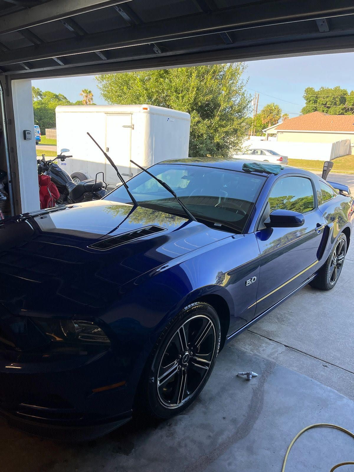

Sorry I too do not have any suggestions as to the source. So is it like a metal rubbing on metal sound? Is it coming from the front of the car or the rear? Left or Right?
Looks like the car is OEM height (not lowered) and tires appear to be standard OEM size so tire rubbing does not look like a problem.
Just wondering could it be the vacuum sounds from the Heat/AC unit?
Give us as much detail as you can. Maybe a recording/video if you if possible, but don't risk a crash.
I too would like to welcome you to TMS from another 2014 Owner. Nice looking... Love to see more pictures,
Thank you for the welcome!
The sound is a bit hard to describe — it's somewhat like a rubbery or whining noise, but still very sharp. It definitely sounds rotational, as if it's coming from something that’s spinning. I believe the sound is coming from the front of the car, and it only occurs when I turn left or right.
You’re correct — both the tires and ride height are OEM.
I don’t think it’s related to the heat or AC, since the sound is clearly coming from underneath the car and is much too loud for it to be something like that.
I’m currently trying to borrow a GoPro from a friend so I can get a clear recording of the sound from underneath the vehicle.
As for photos, I don’t usually take any of my car, but I’ll snap a few so I can share them with you.
