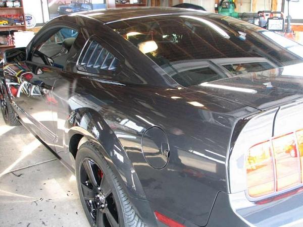

Well, it's tough to remove them without scratching the black paint on the backside around the perimeter. I installed the SHR louvers this weekend and the process was pretty straightforward, but I ate up the paint around the outside of the windows with the wire. I figured, better to hit the window with it than the car, right?
You could probably re-use them if you threw a quick coat of flat black on the backside of the windows near the edge.

I had mine done about 3 weeks ago at glass shop. They did a great job, glass intact, no scatches and all for 135 dollars.
It looks like PenguinGT's
