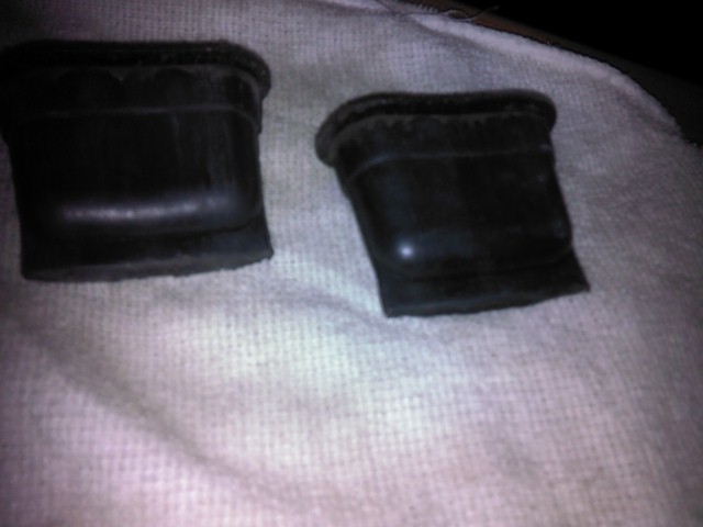

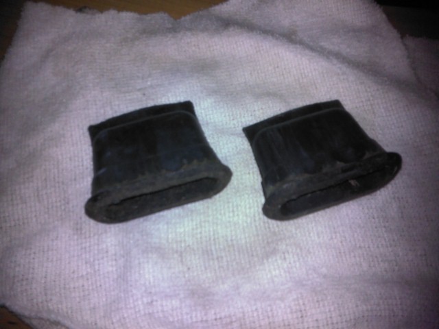

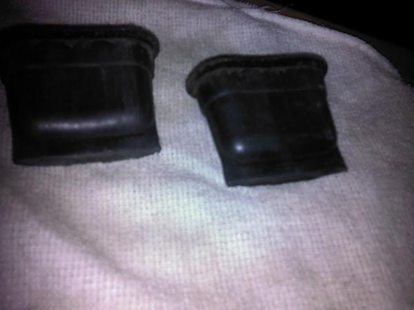

2007 stang.
I got an oil change a few months back and the guy took these out of my car, somewhere under the hood and told me that my car is better off not to have them inside it. They were full of leaves and dirt at the time when he removed them.
I didnt see where he took them out, but I am thinking I should put them back where they are suppose to go. I looked all over under my hood but couldnt see where they would fit into.
Pics included
Attached Thumbnails What part is this? And where does it go?-img_20130214_085241.jpg   What part is this? And where does it go?-img_20130214_085250.jpg   What part is this? And where does it go?-img_20130214_085237.jpg

They've got to be from under the car where the cowl area of the hood drains underneath.
Bingo! They do get blocked by debris (leaves, triggs, etc.) then cause water to pool up inside the cowl area, which then overflows into the cabin, usually damaging the electrical of your Smart junction Box over on the passenger side footwell. I would just reinstall them and make sure they aren't blocked, and maybe replace your cabin air filter while you're at it.

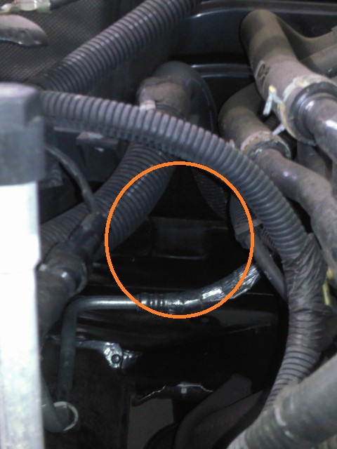

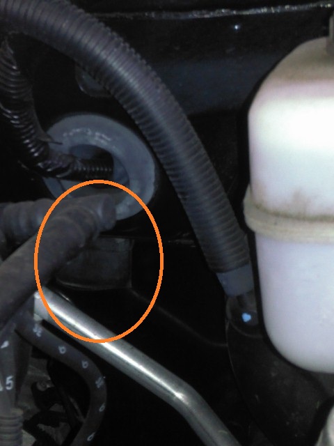

I found this post too
https://themustangsource.com/f739/co...-clean-504787/
It looks to be around the same area of where the guy was sticking his hands tp pull them from.

Old Feb 14, 2013 | 08:08 AM
joeblackis's Avatar
Joined: June 12, 2012
Posts: 17
So both of the areas are vertical and the rubber drainthings just goes point straight down, but with the smaller tips at the top , seems pretty pointless to have them in there. I put them in , by the way the slots are not visible I had to slide my hand all around to finally find the slots, They both snapped right into place though.

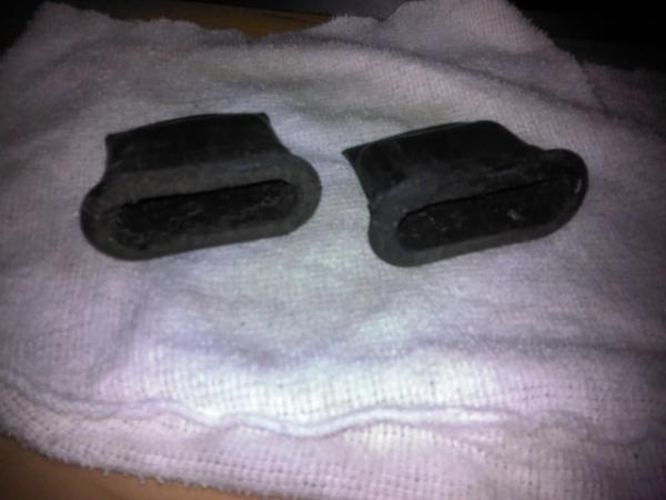

Old Feb 15, 2013 | 12:17 PM
joeblackis's Avatar
Posts: 17
Originally Posted by Nunja Business
"Smaller tips at the top" just sounds logically wrong.
Did you try putting them in the other way?
I plan on climbing into my engine compartment this weekend, so I will be looking at mine!
OK looks like I put them in backwards! lol. I know where they go now from looking at that other picture.
The guy that removed them also said he usually just cuts the tips of them off to make the opening bigger too.
I am not sure why these are even needed, at least in my 07 they seem really pointless because the opening just directly points to the ground.

Old Feb 15, 2013 | 01:03 PM
joeblackis's Avatar
Posts: 17
Installed correct way now.
Attached Thumbnails What part is this? And where does it go?-111.jpg   What part is this? And where does it go?-2222.jpg
Old Feb 16, 2013 | 09:09 PM
nascar_red's Avatar
Joined: January 10, 2013
Posts: 5
From: Frisco, TX
Leave Them Out - or - if you reinstalled them take them back out. They will fill with debris and you WILL have a waterfall into the passenger foot-well. There is a very informative thread on allfordmustangs.com
