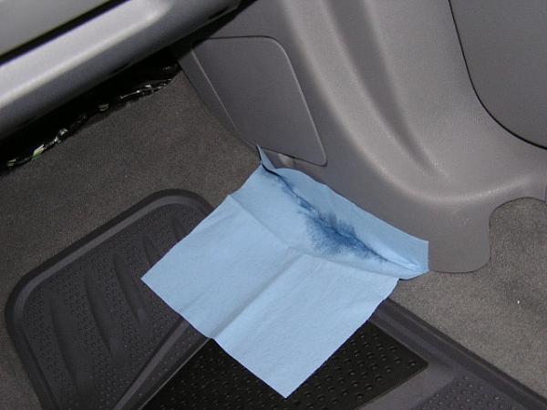

It rained hard two days ago with strong winds. I was driving to the gym yesterday and while I was making turns I heard a noise. I didn't think much of it. Then I kept hearing the noise with each turn and when I accelerated from a complete stop. I looked over to my passenger side floor board and saw water everywhere. With each acceleration and turn water was dripping from underneath the passenger side dash behind the glove box. So the question is: did the rain cause this by somehow getting in between my hood and the windshield or is this cause by something else. All together I would say it was close to a gallon of water leaked into my car. Keep in mind I've had my car for over three years and it has been exposed to the rain and weather but nothing like this has ever happened. Thanks in advance!

I have this pic but need to find the thread

Do a search for "water leak" - it's a known problem that for which Ford has issued a TSB.

Check the drain below where the cabin air filter is located.
There is a small rubber gromet that gets plugged and lets
water come in thru cabin air intake.

J2L06GT is correct...I would bet dollars to donuts that is the problem...

Good luck. Check the grommet under the cabin air filter. You may always want to take it into the dealer to have the SJB/electronics replaced/diagnosed.
