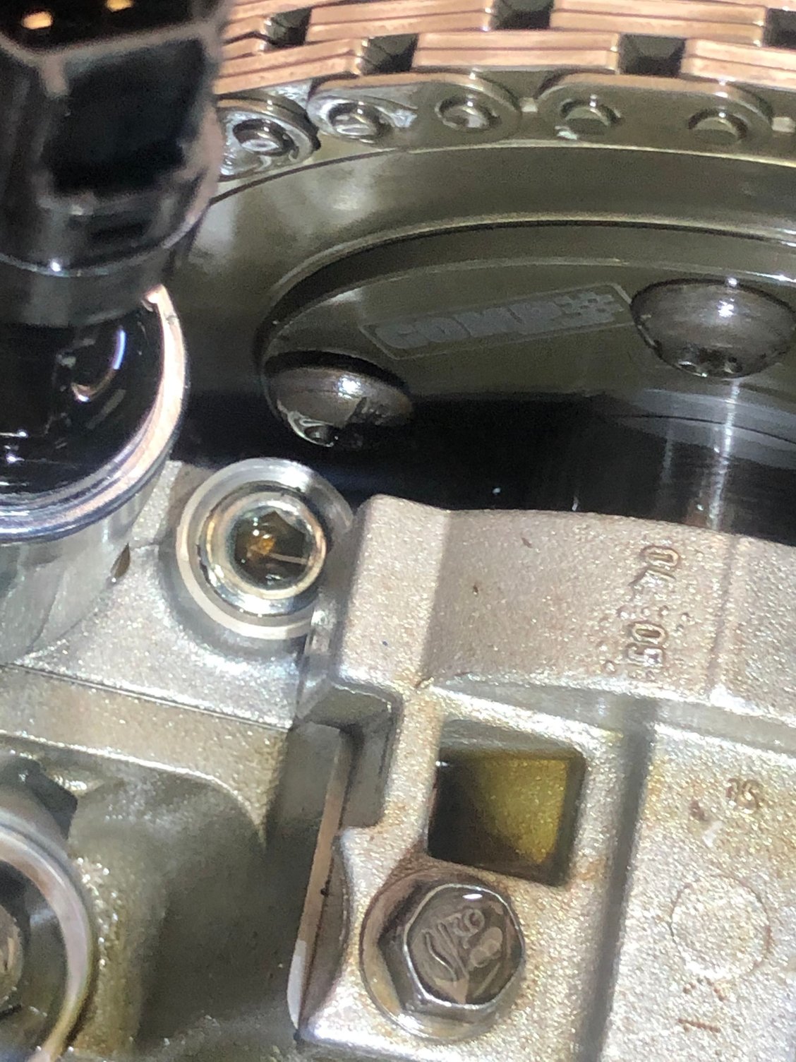

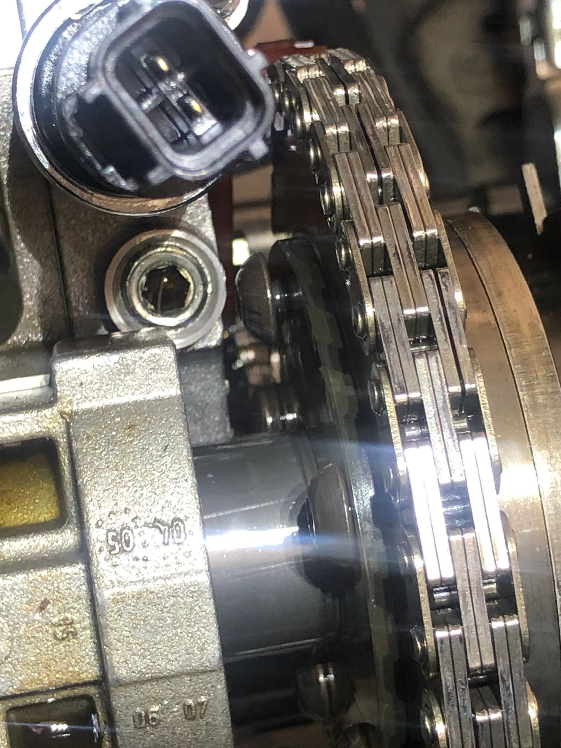

I didn’t mention that I was gettin a random cam code before but since I got it to pass I figured I chase it down. Pulled the front cover this morning to check everything 1st hand an everything looked good other than the front seal an cover gasket. Was jamming to music but a few times I could have sworn I heard a noise from bank 1, finally I turned down the music an gave a good listen an WTF a bolt backing out the rear of the phaser!!!! Guess I’ll head to the dealer an grab a new set

Ok, those are not stock. Well, the phasers are, but those plates on the back are replacements for the original phaser plates, Comp Cams phaser limiters or lockouts, to prevent the computer from moving the cams around too much/at all.
And for what this is worth, there's no way in heck that I'm not putting some orange or at least blue thread locker on those bolts, just because this can happen. That the instructions don't say to do this is deplorable. The Instructions in question, acquired from LMR.com: https://latemodel.cachefly.net/downl...s/CCA-5449.pdf
Did they tell you all the mods that were done? You might want to know all that now, because it seems you are getting gotchas from not having all the info... man. backed out phaser bolt. Just...
/This is why they say 'buyer beware'...

Your absolutely right on all counts. I didn’t realize what they was till I put the 1st one on the bench. End result is I pulled them both off an used a little blue on all the limiter bolts then put them back on with new phaser bolts. I’ll put the cover on an finish it in the am.
